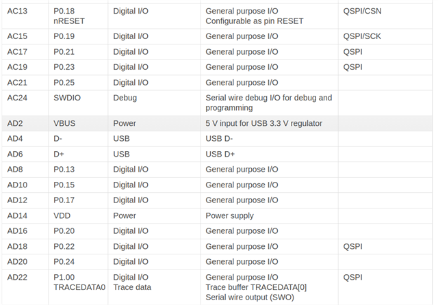

we configured a QSPI application on nRF52840.

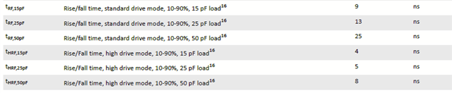

its clock was assigned on p0.04/J1 in hardware design, now we notice that its waveform is close to a square wave as 30MHz maximum, but changes to similar as a sine wave if it is set to 32MHz.
does this mean p0.04 can't be run as such high frequency usage? or only the recommended usage is allowed for QSPI application?
