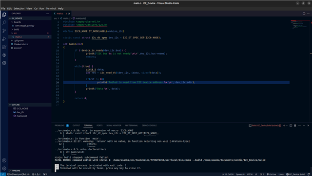

Error When Compiling I2C Code
I wrote a sample code to read 8bits from an I2C device as below.
#include <zephyr/kernel.h>
#include <zephyr/drivers/i2c.h>
#define I2C0_NODE DT_NODELABEL(arduino_i2c)
static const struct i2c_dt_spec dev_i2c = I2C_DT_SPEC_GET(I2C0_NODE);
        if (!device_is_ready(dev_i2c.bus)) {
	        printk("I2C bus %s is not ready!\n\r",dev_i2c.bus->name);
	        return;
        while(true) {
                uint8_t data;
                int ret = i2c_read_dt(&dev_i2c, &data, sizeof(data));
                if(ret != 0){
	                printk("Failed to read from I2C device address %x.\n", dev_i2c.addr);
                printk("Data %x", data);
        return 0;
But I get the following error when I try to compile.

I'm quite new to this platform and I appreciate any help with this. Thank you.
  • Hi
    If you are new to Nordic I would strongly check out the Nordic Developer Academy. The introductory course even includes a chapter dedicated to I2C which should help you get started.
    I expect the problem with your sample is that you haven't created an I2C sensor in your overlay. The I2C_DT_SPEC_GET() macro will not work on the I2C top node itself, you have to use it with one of the sensors (or buses) on the I2C interface. The devacademy chapter will explain this in more detail.
    Best regards
    Torbjørn

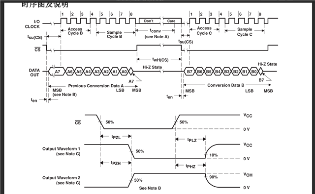

  • Thank you. This is the device that I'm trying to control. It's an ADC.
    I will take a look at the overlays. I appreciate the support.
  • Hi
    That looks like an SPI device to me, not an I2C device. If this is the case the I2C interface will struggle to communicate with it, since it will not receive any acknowledge.
    Best regards
    Torbjørn
    I think you're right. It seems to be an SPI device. Since it had only CLOCK and DATA, I thought it was I2C. I wrote the code for an SPI device but it doesn't initialize. Can you please let me know what I'm doing wrong?
    The device boots and then prints 'Device not ready...' and reboots.

    I think I figured it out. I managed to get SPI working after setting up the code as below.
    Read successful. Data: 255
    Code:

    If you only read 255 (b11111111) it does point to some communication or sensor issue, as this probably means the MISO line is constantly high, rather than receiving actual data.
