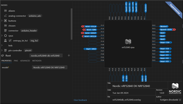

    In the case of GPIO, strangely enough, I figured out that only several GPIOs can be used for IO purposes. I am not sure what the reason for this is and there doesn't seem to be a pattern. This is the code for it.

    The traces are pulled up on the PCB itself so it should be an open drain or push-pull from the microcontroller. Only a handful of available GPIOs respond when I try to control them. Maybe you can suggest a reason why this is happening? Thanks for the support! Couldn't have done it without your code and suggestions.
  • Hi
    If you only read 255 (b11111111) it does point to some communication or sensor issue, as this probably means the MISO line is constantly high, rather than receiving actual data.
    The nRF5340 chip on the nRF7002DK uses a lot of GPIO's for connecting the nRF7002, external flash memory, buttons, LED's and other things. Possibly the GPIO's you are unable to control are already assigned to some of these other functions?
    You can get a visual representation of your board file in VSCode which shows you at a glance what the various IO pins are assigned to. Not sure you have tried this out?
    It should look something like this:
    Best regards
    Torbjørn
