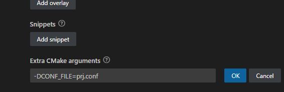

Update: When I explicitly add "Optimization level: Optimize for debugging (-Og)" the following "Extra CMake arguments" are added:
-DCONFIG_DEBUG_OPTIMIZATIONS="C:/Users/daubsi/AppData/Local/Programs/Microsoft VS Code/y"
-DCONFIG_DEBUG_THREAD_INFO="C:/Users/daubsi/AppData/Local/Programs/Microsoft VS Code/y"
that seem awkward.

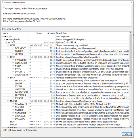

Then I tried to choose "Debug with Ozone" instead and once I "Download and Reset program" there I am receiving a bus fault:
What am I doing wrong?
    This part looks a bit concerning though. Have you manually added these paths in kconfig, or was it this way by default for you? it should be DCONFIG_DEBUG_THREAD_INFO=y.
    Elfving
    no I havent't added those. They appeared once I chose the option in the build config to create extra debug info. I agree these don't look right.
    that seem awkward.
  • Hmm yeah that's not supposed to be like that.
    No breakpoints are hit and I cannot do anything. Switching back to the "cpuapp" variant, everything works again.Shouldn't be "cpuapp_ns" be the "better" variant in general?
    There should be no problem running the Blinky sample using non-secure. You are right in that taking advantage of TFM and separating the application into a non secure and secure part is good, given that you do this separation well (and take advantage of the relevant APIs etc., which you typically want to do in a real product). Though simply using an ns version of the board isn't preferable by itself per se, especially for testing purposes. Though TFM is a tricky topic.
    The secure vs non-secure partition wouldn't have control over certain pins by default. Though that is interestingly the case for the nRF5340, that the network core have control over certain pins, and you would need to make some changes in the dts in order to change that.
    Though back to the problem. Do those paths to /Users/daubsi/AppData/Local/Programs/Microsoft VS Code/ still pop-up in your build log when you build it for the default board? And that does still fail right?
    If you just build the regular Blinky sample, and add the "Extra cmake argument" -DCONF_FILE=prj.conf, does the path to /Users/daubsi/AppData/Local/Programs/Microsoft VS Code/ still pop-up in your build log? Does it build?
    Elfving
    Elfving
