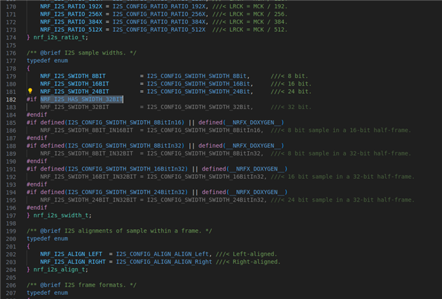

    I also dug through the sample_width parameter definitions and tried out I2S_CONFIG_SWIDTH_SWIDTH_16BitIn32 (#defined as 0x6), which did allow me to hit a ratio of 48 BCLKs per LRCLK. I tried I2S_CONFIG_SWIDTH_SWIDTH_8BitIn32 (#define as 0x5), but that again gives me an observed ratio of 32.

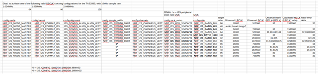

    Here is a table I created of the I2S config parameters I have tested, and the output clock speeds I have observed on my oscilloscope:
    My target I2S parameters:
    -16kHz sampling
    -Mono audio
    -16 bits/sample
    -BCLK to LRCLK ratio of 64, 96, or 128 (so, BCLK freq of 1.024MHz/1.536MHz/2.048MHz)
    Is there a process behind the scenes that is calculating clock speeds automatically?
    Why isn't the nrfx_i2s_config_t.ratio parameter being respected?
    What other parameters can I change to hit 64 BCLKs per LRCLK?
