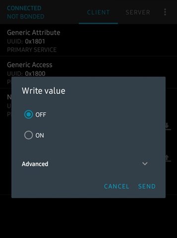

I am currently working with the nRF Connect SDK v2.4.0 to develop applications for custom boards based on the nRF52840 microcontroller. I have included custom GATT Services and Characteristics which include controlling the sensor (ON/OFF). From the below link and few other sources.
https://academy.nordicsemi.com/courses/bluetooth-low-energy-fundamentals/lessons/lesson-4-bluetooth-le-data-exchange/topic/blefund-lesson-4-exercise-1
As I click on 'WRITE' icon after flashing the code. This is the output I get,
instead of this as given in the link above.
I have added the write functionality as mentioned in the above link.
