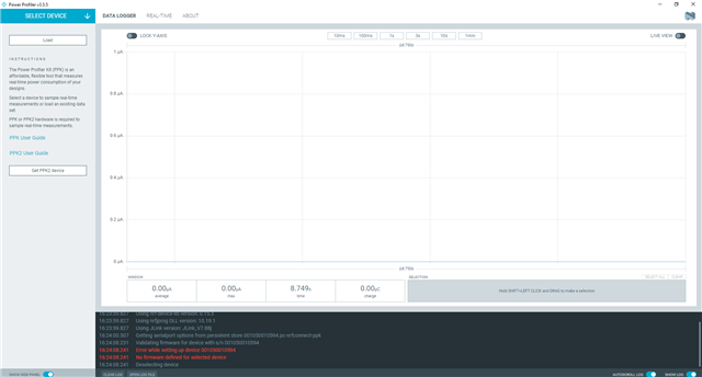

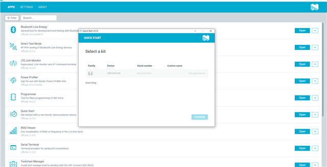

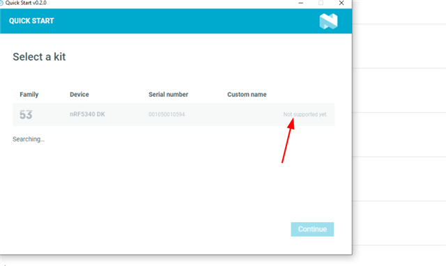

While I tried using nRF connect for desktop and while using "Quick start" tool, it only stays in the searching for device window and doesn't show any progress from there.
the tool shows a window like this and stays there.

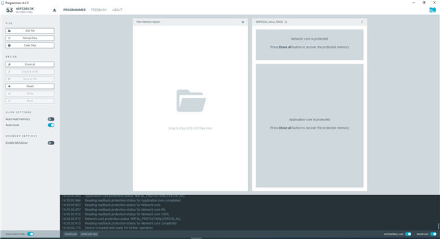

And while using PROGRAMMER application, it shows the device is connected, "Device is loaded and ready for further operation". But where can I find the hex files to program the device.

    This app is currently only support for the nRF91 series. This is why your nRF5340 DK shows up as unsupported.
    To get started, I recommend going through the SDK fundamentals course at https://academy.nordicsemi.com/courses/nrf-connect-sdk-fundamentals/. You will need to install the SDK to build and configure the hex files you want

  • Hi Vidar,
    Aint the programmer come as part of the nRF Connect?
    on opening programmer from nRF Connect I'm getting the below window.

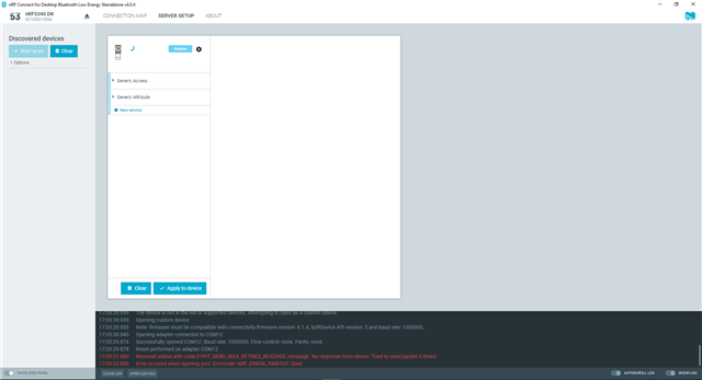

    Also while trying to use the "Bluetooth Low Energy" Tool in nRF connect, I'm getting this below window saying, "Error occured when opening port. Errorcode: NRF_ERROR_TIMEOUT (0xd)",
    How to resolve this and execute programs to configure the chip in BLE modes?

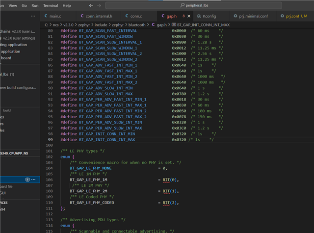

    one more doubt I was trying to configure the connection interval in periheral_lbs example in gap.h file.
    but it is not setting the connection interval right.
    #define BT_GAP_INIT_CONN_INT_MIN                0x0320  /* 1s    */
    #define BT_GAP_INIT_CONN_INT_MAX                0x0320 /* 1s    */
    how to set the connection interval to 1?
    by setting below parameters, I was able to set advertisement to 1second,\
    #define BT_GAP_ADV_FAST_INT_MIN_1               0x0640  /* 1s    */
    #define BT_GAP_ADV_FAST_INT_MAX_1               0x0640  /* 1s    */
    #define BT_GAP_ADV_FAST_INT_MIN_2               0x0640  /* 1000 ms   */
    #define BT_GAP_ADV_FAST_INT_MAX_2               0x0640  /* 1000 ms   */
    aslso like you suggsted peripheral_lbs program for sleep, advertisement and connected case. can you tell me which program can be used for Scan, RX and TX?

  • Hi Arun,
    The BT_GAP_* symbols in gap.h define common default values for use by the application. This file should not be modified.
    The connection interval is ultimately determined by the GAP central connecting to your device. However, you can request a specific connection interval or range from the central by adding the following symbols to your prj.conf file:
    - CONFIG_BT_PERIPHERAL_PREF_MAX_INT
    - CONFIG_BT_PERIPHERAL_PREF_MIN_INT
    If you want to measure the connection events, you can connect to the peripheral from an Android or iOS app with our nRF Connect app.
    Vidar

    Thank you for the response. But on changing the parameters in gap.h for advertisement interval, it was working,
    is this why I'm facing issue in changing scan parameters as well?

  • Hi Arun,
    It's not that it doesn't work, but you should generally avoid modifying source files in the SDK tree. When you change this definition, it will change the advertising interval not just for your project, but also for any other project using the same symbol.

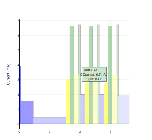

    Could you please provide more details about what you are trying to evaluate? TX and RX currents can be measured during connection events, as illustrated by the power profiles in our online power profiler. What is the purpose of testing with a 100% duty cycle?

  • Hi Vidar,
    how exactly can we measure TX and Rx cases in connected event can you explain the process also is there any other nRF connect examples for these??
    Arun
  • Hi Arun,
    You can find the RX and TX currents by inspecting the advertising or connection event. The events should the same as the events shown in our online power profiler.
