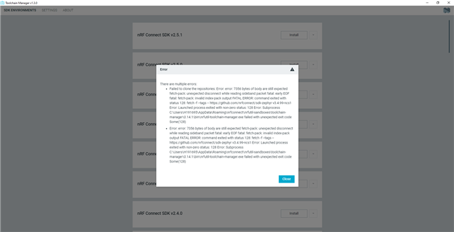

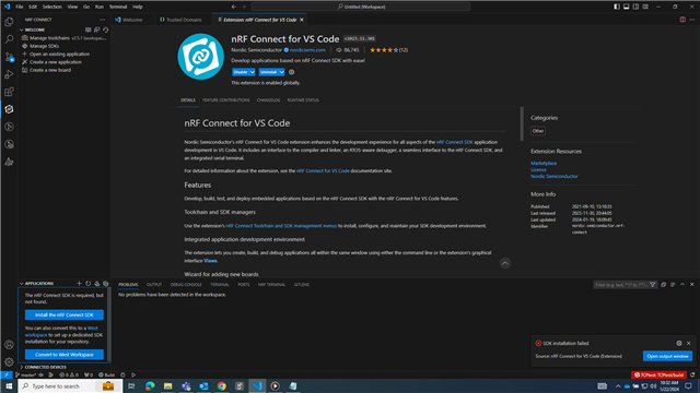

Unable to install any SDK( ex. 2.50)
Getting this error while installing SDK 2.50
  • This image is unreadable, I'm afraid.
    Have you verified with your IT department that you have access to Github?

  • Hi Team,
    Can you please respond to my previous response.
    Sravan Rikka
  • Thanks for sharing. I will forward to our developers. We are looking into this. Have you tried to uninstall and reinstall nRF Connect for Desktop?
    Have you tried with another network, e.g. home network or similar? Just to verify that this is not a network issue?
    Yes, I have uninstalled and reinstalled several times and observed same error.
    I haven't tried different network, let me try it.
