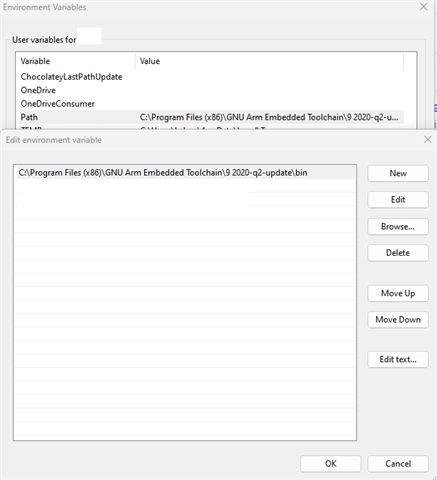

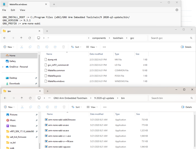

    1. Download the GCC toolchain at https://developer.arm.com/downloads/-/gnu-rm/9-2020-q2-update and run the installer. Then, ensure that the 'GNU_INSTALL_ROOT' path in /nRF5_SDK_17.1.0_ddde560/components/toolchain/gcc/Makefile.windows corresponds with your installation directory.

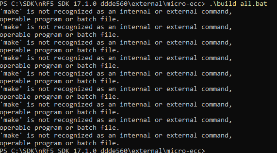

    2. Download a version of GNU Make (make.exe) and add the location of this executable to the PATH so that it can be called from the terminal. I've been using the GNU Make version bundled with this package: https://github.com/xpack-dev-tools/windows-build-tools-xpack/releases/. You can run 'make --version' from powershell afterwards to check that it is working.
    3. From the terminal, run the build_all.bat script in /nRF5_SDK_17.1.0_ddde560/external/micro-ecc to fetch uECC source code from github and build all variants of the uECC library.
  • Hey Vidar
    I ran the gcc-arm-none-eabi-9-2020-q2-update-win32.exe and it looks like it autopopulated this all, but chime in if you see something wrong please;
    1)
    2)
    3) Then these errors;
    Sorry this windows scripting stuff isn't my strong suit, so definitely appreciate you helping me work through it.
