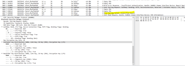

  • Thanks for your further instructions, Hung!
    I've made another capture based on the instructions. Is it useful this time?
    mac.pcapng
  • Hi Mlac,
    Thanks for the trace. I can see that the nRF52840 rejected the pairing with "Unspecific reason".
    I'm checking internally to see why this happens.
    I assume you were testing with unmodified peripheral_hids_keyboard sample ? ( with CONFIG_NFC_OOB_PAIRING=n ?)
    Could you send us the trace when it can connect and pair with other device not the MAC so we can compare ?
    Could you try testing with the peripheral_hids_mouse and check if you have the same problem (and give us the trace)

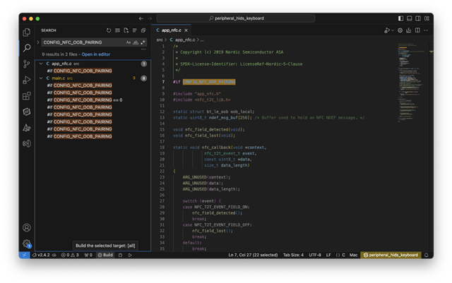

  • Hi again,
    Please also add CONFIG_BT_SMP_LOG_LEVEL_DBG=y to the code and send us the log if it actually show any extra information on why it reject the pairing request.
  • Hi Hung,
    I haven't had CONFIG_NFC_OOB_PAIRING enabled, and I've enabled CONFIG_BT_SMP_LOG_LEVEL_DBG for the following tests as requested:
