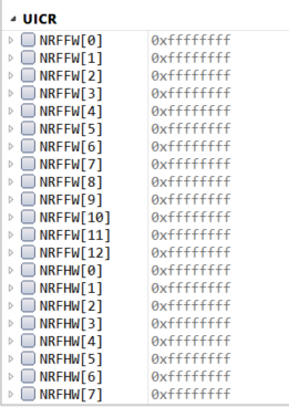

2. I get it the last address on the last page is equal to UICR.NRFFW[0]. But why every value of NRFFW is 0xffffffff? Is there other meaning that I didnt find?
    Similar to the registers above, you can find the NRFFW registers documented in the UICR documentation page. They are registers reserved for Nordic's software usages.
    However, I don't think it store the last address of the last page, whether we are talking about the fstorage reserved area, or the entire flash memory. Why did you think that is the case.
    I see that NRFFW[0] can store the last address of the last page of the fstorage area when you use a bootloader, and set the fstorage area to end at the address right before the bootloader starts.
    The fact that NRFFW[0] have the last fstorage address is just a coincidence then. NRFFW[0] store the bootloader's start address in our bootloader solution.
    Also, technically, the last fstorage byte address should be (NRFFW[0] - 1) in this case.
    In this scenario, NRFFW[1] should not be 0xFFFFFFFF though. Refer to the Bootloader documentation linked above and see that it should store the start address of MBR Parameters.
    As for why the other NRFFW registers all have the value 0xFFFFFFFF, it is simply because that is the default value of the registers after an erase.
