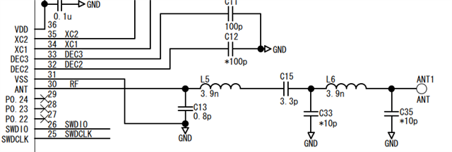

Immunity test <IEC61000-4-3 (10V/m 80MH-2700MHz)> was conducted on NRF52832-QFAA.
・Frequency increases by 1%.
・Stay time 3 seconds
NRF52832 resets at 2.1 GHz when the radio frequency is increased from 1 GHz.
NRF52832 resets at 2.6 GHz when the radio frequency is decreased from 2.7 GHz.
The figure below is a circuit diagram.
Items marked with * are not mounted.
 _
The figure below is a drawing of the board.
Is there any software or hardware countermeasure I can take?

I would like to know what we can try and the specific steps and methods to do so.
I would like to ask for your help.
