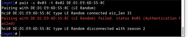

I use the bluetoothctl tool to do the test ....
Please see the example below :

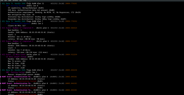

  this is the btmon debug of the session when trying the pairing
Any idea why the pairing is failing all the time although I am able to pair using the nrf connect phone app ?

  • Hi Ibrahim
    Are you using a standard nRF52DK, or some other hardware?
    Is there any chance that there is some old pairing data in the nRF52 device that is causing issues when you try to pair with your Linux host?
    If you perform an erase all on your nRF52 device before programming the application will the same problem still occur?
    Are you able to view the log output from the nRF52 device in order to see if it provides some more useful information?
    If all else fails you might want to capture a sniffer trace of the exchange, using either a professional Bluetooth sniffer or the free one we provide: nRF Sniffer

  • Hi Ibrahim
    Did you try to perform a full chip erase like I asked?
    In order to investigate further I think we need a sniffer trace, the log messages are all very generic and don't include much details about what is failing.
    Can you follow the link I shared earlier and get the sniffer running, and capture a trace showing the connection establishment and the authentication failure?
    Then you can save the trace to file in Wireshark and attach the trace to this case.

  • Ok So I solved the problem with erasing the external memory where i saved the keys of the encryption and settings also I run this command in my terminal : unblock <mac_address>
    This two things solved my problem
