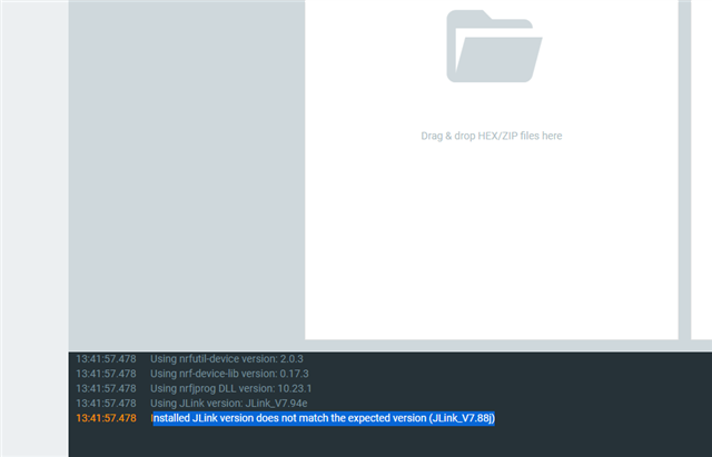

Installed JLink version does not match the expected version
Hi there,
We have recently upgraded to nrf Connect for Desktop 4.3.0. We also upgraded to nrf Command line Tools to 10.24.0.
However, none of the desktop apps are now able to detect the devices.
For example, in the programmer app, with a nrf5340 DK connected, nothing shows up. There is however an error: Installed JLink version does not match the expected version (JLink_V7.88j):
Please advise what is going on here? It is super frustrating that nothing ever works after an upgrade to the software! Hours have been wasted on our end.

  • Hi
    Could you restart your application in verbose log and post the log here.
    You can turn on verbose logging by opening the about tab, and then turn on verbose logging.
    Which operating system are you using?
    Regards
    Runar
  • Log below. Please note I uninstalled JLink version7.94e. No error message is present now, however the devices still does not show up. Running on Windows 10.

    2024-01-31T12:12:39.511Z DEBUG [PID:2248] [jlink] [NRFJPROG][SeggerBackend][-] ---just_enum_emu_snr
    2024-01-31T12:12:39.511Z DEBUG [PID:2248] [jlink] [NRFJPROG][SeggerBackend][-] ---just_get_num_emus
    2024-01-31T12:12:39.511Z DEBUG [PID:2248] [jlink] [NRFJPROG][SeggerBackend][-] is_connected_to_emu
    2024-01-31T12:12:39.511Z VERBOSE [PID:2248] [jlink] [NRFJPROG][Worker][-] Command enum_emu_snr executed for 3 milliseconds with result 0
    2024-01-31T12:12:39.558Z DEBUG [PID:2248] [jlink] [NRFJPROG][nRFXX][-] close
    2024-01-31T12:12:39.558Z DEBUG [PID:2248] [jlink] [NRFJPROG][SeggerBackend][-] is_connected_to_emu
    2024-01-31T12:12:39.558Z DEBUG [PID:2248] [jlink] [NRFJPROG][SeggerBackend][-] close
    2024-01-31T12:12:39.558Z DEBUG [PID:2248] [jlink] [NRFJPROG][SeggerBackend][-] disconnect_from_emu
    2024-01-31T12:12:39.558Z DEBUG [PID:2248] [jlink] [NRFJPROG][SeggerBackend][-] Segger Backend closed.
    2024-01-31T12:12:39.558Z DEBUG [PID:2248] [jlink] [NRFJPROG][nRFXX][-] nRF family DLL closed
    2024-01-31T12:12:39.573Z VERBOSE [PID:2248] [jlink] [NRFJPROG][Worker][-] Command close executed for 45 milliseconds with result 0
    2024-01-31T12:12:39.573Z VERBOSE [PID:2248] [jlink] [NRFJPROG][Client][-] Command close executed for 62 milliseconds with result 0
    2024-01-31T12:12:39.573Z DEBUG [PID:2248] [jlink] [NRFJPROG][Client][-] terminate
    2024-01-31T12:12:39.573Z VERBOSE [PID:2248] [jlink] [NRFJPROG][Client][-] Command terminate executed for 0 milliseconds with result 0
    2024-01-31T12:12:39.588Z INFO Using nrfutil-device version: 2.0.3
    2024-01-31T12:12:39.588Z INFO Using nrf-device-lib version: 0.17.3
    2024-01-31T12:12:39.588Z INFO Using nrfjprog DLL version: 10.23.1
    2024-01-31T12:12:39.589Z INFO Using JLink version: JLink_V7.88j
    2024-01-31T12:12:39.589Z VERBOSE [PID:2248] [jlink] [NRFJPROG][Worker][-] Command terminate executed for 0 milliseconds with result 0
    2024-01-31T12:12:39.589Z VERBOSE [PID:2248] [jlink] [NRFJPROG][Worker][-] Executed 4 commands for 52 milliseconds
    2024-01-31T12:12:39.622Z DEBUG [PID:2248] [jlink] [NRFJPROG][Client][-] Worker process exited with code: 0
    2024-01-31T12:12:39.623Z DEBUG [PID:2248] [jlink] [NRFJPROG][Client][-] Child process terminated with result 0
    2024-01-31T12:12:39.623Z VERBOSE [PID:2248] [jlink] [NRFJPROG][Client][-] Executed 4 commands for 115 milliseconds
    2024-01-31T12:12:39.623Z DEBUG [PID:2248] [jlink] [NRFJPROG][Client][-] terminate
    2024-01-31T12:12:39.651Z DEBUG [PID:2248] Enumeration for plugin 'jlink' took 264 ms
    2024-01-31T12:12:39.652Z VERBOSE [PID:2248] [boardController] C API function: enumerate
    2024-01-31T12:12:39.662Z DEBUG [PID:2248] [boardController] Found 16 HID devices.
    2024-01-31T12:12:39.662Z DEBUG [PID:2248] Enumeration for plugin 'BOARDCONTROLLER' took 10 ms
    2024-01-31T12:12:39.662Z DEBUG [PID:2248] [SerialPortListerHW::WIN32] try to map FTDI to segger device
    2024-01-31T12:12:39.662Z DEBUG [PID:2248] Enumeration for plugin 'serialport' took 0 ms
    2024-01-31T12:12:39.662Z DEBUG [PID:2248] Enumeration for plugin 'sdfu' took 0 ms
    2024-01-31T12:12:39.662Z DEBUG [PID:2248] Enumeration for plugin 'mcuBoot' took 0 ms
    2024-01-31T12:12:39.662Z VERBOSE [PID:2248] [broken] BrokenPlugin::enumerate
    2024-01-31T12:12:39.662Z DEBUG [PID:2248] Enumeration for plugin 'broken' took 0 ms
    2024-01-31T12:12:39.662Z VERBOSE [PID:2248] DeviceLister::enumerate: Found device with serial number: '{007735DE-D307-5E6D-AB16-BCD7F0531FA4}'
    2024-01-31T12:12:39.662Z VERBOSE [PID:2248] DeviceLister::enumerate: Found device with serial number: '{00000000-0000-0000-FFFF-FFFFFFFFFFFF}'
    2024-01-31T12:12:39.662Z VERBOSE [PID:2248] DeviceLister::enumerate: Found device with serial number: '{69A97996-F00F-11ED-8797-AC91A12D36FD}'
    2024-01-31T12:12:39.662Z VERBOSE [PID:2248] DeviceLister::enumerate: Finished in 280 ms
    2024-01-31T12:12:39.662Z VERBOSE [PID:2248] DeviceLister::enumerate: Completed waiting for enumerate task
    2024-01-31T12:12:39.662Z VERBOSE [PID:2248] DeviceLister::enumerate: done
  • After uninstalling version 7.94e, and restarting, it works successfully.
