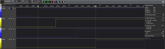

The following 4 signals should rise at the same time, however they are 1.85 us out of sync.
Triggering the PWM SEQSTART tasks manually has the same result:
    nrf_pwm_task_trigger(NRF_PWM0, NRF_PWM_TASK_SEQSTART1);
    nrf_pwm_task_trigger(NRF_PWM1, NRF_PWM_TASK_SEQSTART1);
    nrf_pwm_task_trigger(NRF_PWM2, NRF_PWM_TASK_SEQSTART1);
    nrf_pwm_task_trigger(NRF_PWM3, NRF_PWM_TASK_SEQSTART1);

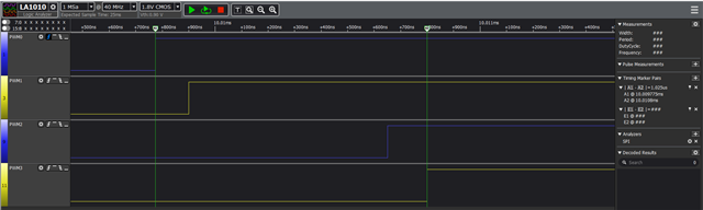

Strangely enough, if I reverse the order in which I start the PWMS:
The PWM signals are still generated in order PWM0->PWM3
Can anyone explain this? Is there no way to start the PWMs at the same time?

  • You may be observing an artifact on the logic analyser sampling mode; do you have a high-bandwidth oscilloscope available?
  • The LA1010 is only a 20MHz logic analyzer with typically 40MHz sampling - this is nowhere near good enough to measure the offset correctly. I tested this code with a 300MHz oscilloscope at 2GHz sampling and there is no measurable phase offset as shown on traces included earlier with no loading on the pins. You may be observing an artifact on the logic analyser sampling mode
  • You can improve the LA1010 logic analyser performance by reducing the slope on the PWM output signals, high-drive H0H1 helps with this:

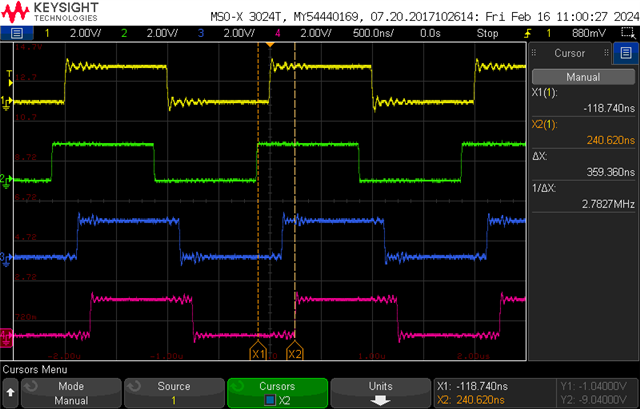

  • This was measured with an InfiniVision MSO-X 3024T (200 MHz, 5GSa/s).
    I also changed the signals to high-drive (but this did not seem change much) :/
  • I agree with your findings, and have the tested fix which I post here. Interestingly my testing on the nRF52832 does not show this behaviour, it only seems to happen on the nRF52833 and would have impacted my current project which happens to be replacing the nRF52832 with the nRF52833 so thanks for raising this :-)
    The cause is in this mode each PWM reads data on start from RAM using DMA via the AHB bus network; each PWM is a Bus Master, and RAM is a group of Bus Slaves. Priority of the Bus Masters is PWM0/PWM1/PWM2/PWM3 which explains one of your earlier comments.
    These are my notes on AHB Bus Masters:
    // nRF52833 Bus Masters
    // Each bus master is connected to all the slave devices using an interconnection matrix. The bus masters are
    // assigned priorities, which are used to resolve access when two (or more) bus masters request access to
    // the same slave device. When that occurs, the following rules apply:
    // - If two (or more) bus masters request access to the same slave device, the master with the highest
    // priority is granted the access first.
    // - Bus masters with lower priority are stalled until the higher priority master has completed its transaction.
    // To avoid AHB bus contention when using multiple bus masters, follow
    // these guidelines:
    // - Avoid situations where more than one bus master is accessing the same slave.
    // - If more than one bus master is accessing the same slave, make sure that the bus bandwidth is not exhausted.
    // Below is a list of bus masters in the system and their priorities.
    //  PWM0
    //  PWM1
    //  PWM2
    //  PWM3
    To avoid a 2-cycle 16MHz stall on the Bus Masters, the 4 x PWM cannot share the same AHB Bus Slave, and RAM is a Bus Slave:
    //  PWM0
    //  PWM1
    //  PWM2
    //  PWM3
    //           Name  AdrSpace    StartAdr    EndAdr      AccType
    // Memory =  RAM0  Memory      0x20000000  0x20001FFF  RW
    // Memory =  RAM1  Memory      0x20002000  0x20003FFF  RW
    // Memory =  RAM2  Memory      0x20004000  0x20005FFF  RW
    // Memory =  RAM3  Memory      0x20006000  0x20007FFF  RW
    // Memory =  RAM4  Memory      0x20008000  0x20009FFF  RW
    // Memory =  RAM5  Memory      0x2000A000  0x2000BFFF  RW
    // Memory =  RAM6  Memory      0x2000C000  0x2000DFFF  RW
    // Memory =  RAM7  Memory      0x2000E000  0x2000FFFF  RW
    // Memory =  RAM8  Memory      0x20010000  0x2001FFFF  RW
    The fix is to allocate a separate RAM Slave for each PWM; a nuisance, but it works.
    #define SEQUENCE_SIZE  2
    #pragma location = 0x20006000

  • You're welcome, interesting issue.
    Edit!! Common exhibits the same issue as Grouped; I was testing on the wrong board when I wrote this, but I'll leave the code here edited for Common Mode.
    Further testing shows this issue applies to PWM Grouped Mode, which I am using to get differential outputs using 2 pins on each of the 4 PWMs. Single output mode using PWM Common Mode and a single output pin does not also exhibits this issue on the nRF52833.
    In Grouped Mode (2 x 16-bit DMA transfer), as with Common Mode (1 x 16-bit DMA transfer), I would expect a single 32-bit DMA transfer with unused bits discarded, but maybe that is different from the nRF52832. I tried lots of different frequencies, but frequency doesn't seem to be an issue.
    This is the test code for Common (single-ended) outputs which does not also requires using separate RAM Slave addresses:
    static void EnableExtClockPWM(NRF_PWM_Type * const pPWM, const uint32_t PWM_Pin, const uint16_t * const pSequence);
    #define PWM_CH0_DUTY 2                      // 50% duty cycle; 2*2 clocks/period at 16MHz -> 4MHz
    #define PWM_CH1_DUTY PWM_CH0_DUTY | (1<<15) // Ditto, polarity bit set so inverse of CH0 for differential outputs
    #define SEQUENCE_SIZE  1
