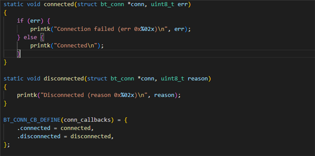

    Some events such as connected and disconnected you have to pass a specific callback handler like this:

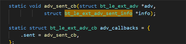

    1.  For advertising, when advertising start i expecting event and also advertisement stop  i expecting event. In NRF5 SDK there is one callback function called on_adv_evt(). This function will call when advertising event happen such as start advertising and stop advertising. as shown in below snippet .

    So where i register this type of callback function.
    Using this event i want to start and stop blink led for advertising also when advertising will stop i want to system goes into sleep mode. That what i am expecting.

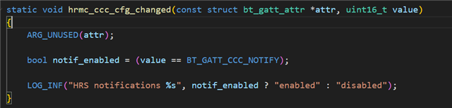

    2. In my custom service i also want event. for example any characteristic will notify i want event and i have to handle that event. Like below snippet from nrf5 sdk.

    For this feature you have to use extended advertising API. The extended advertising API allows you to send legacy advertising packets as well. You can use this callback handler for that. You can start toggling the LED when you start advertising and stop it once the callback handler is called.
    You can setup it like this:

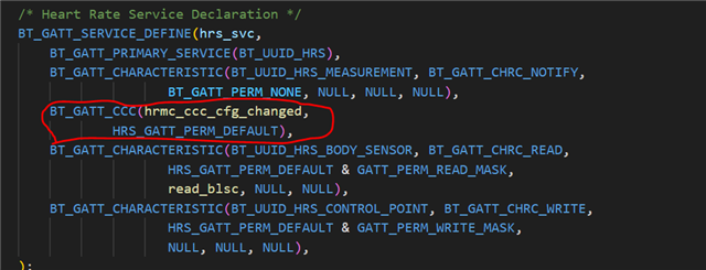

    This is shown in the ble_app_hrs sample, see hrs.c:
