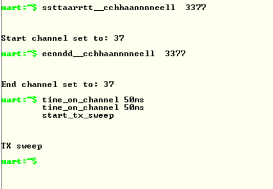

coming back to the topic we were discussing,
I flashed "radio_test" example for testing RF on the board, but on issuing "output_power" command, I'm not seeing any power on measuring from the antenna, nor I'm seeing any increase in cureent numbers, the current profile also doesnt looks like that of tx.
How to execute RF measurements on the device?
Arun
Hi
Could you describe your test setup?
When you use the radio_test example. Could you describe or post the log from the interaction with it? The output_power command is used to set output power, not to start the RX or TX transmission as seen in the user interface table.
Regards
Runar
HI,
Flashing the example, I've set both start and end channel as 37 (2402mHz) so that the Tx sweep will happen only in channel 37.
But I'm not seeing any output power on my power meter which is also set in 2402mHz frequency.
Arun
