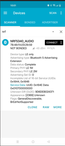

I am working on dissecting the nrf5340 audio application to include only the necessary bits to make a custom gateway on a nrf5340 audio DK. I am using the example application built as a headset device on another Audio DK to test my application. I am at the stage now where I can scan for advertisements, but I can't find the advertisement from my headset device.
It shows up in the nrf Connect mobile application so I know it is advertising, but I don't receive the advertisement on the gateway. Is there anything special that needs to be added to scan for LE Audio devices? I can receive advertisements from all other bluetooth devices in the area.

    Screenshot from nRF Connect app:
  • After doing some more investigations I found out all the devices I was able to scan for was the ones with legacy advertisements. I found out I had to enable extended advertisements in the configuration for the central/gateway to be able to scan for them ( I didn't include the configs because I thought they were for the peripheral creating the advertisements). This ticket helped me: https://devzone.nordicsemi.com/f/nordic-q-a/93525/scan-extended-advertising-with-nrf-connect-desktop/394357

  • Sorry I should have specified that after I updated these configurations I was able to detect my headset device, so it's sorted out now :) I am using the same parameters as in the Audio Application so active scanning and filter duplicates.
