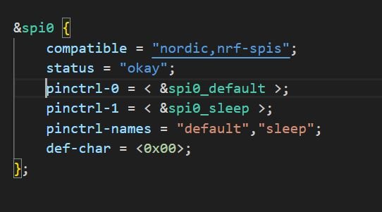

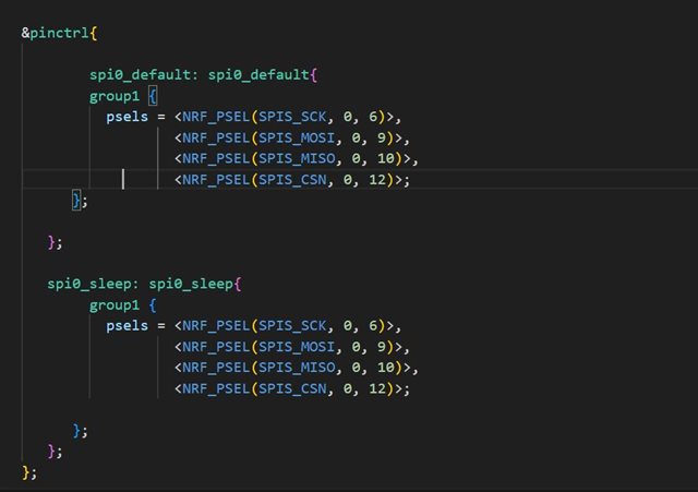

i have created a custom board of nrf52811 Soc and want to use  nrf52811 in slave mode with STM32 SPI masater.
i have created pinctrl.dtsi and dts file as per below images. is this a correct way to configure SPI0 in salve mode?
I am using nrf connect SDK version 2.5.2

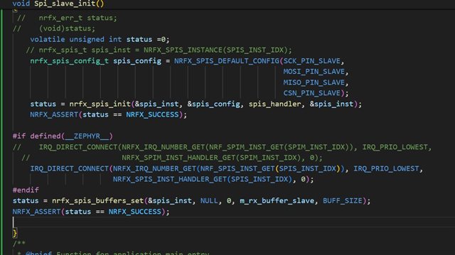

    1. CS pin whether i can use cs pin in pinctrl file or i have to use it as a gpio? if yes how to configure it (GPIO PIN or GPIOTE pin)
    The CS pin must be assigned in the SPIS HW peripheral when the SPI Master initiates a transfer, see the description of SPI slave operation in the nRF52811 Product Specifications.
    If you are using the nrfx_spis driver to configure the SPIS peripheral, it is not required to configure the CS pin in the devicetree/pinctrl, since the pin is set in the driver configuration struct. The devicetree/pinctrl nodes is used when Zephyr drivers are used to configure the peripheral.
    If you have control of both sides of the SPI bus, you can technically configure the CS pin as a GPIO interrupt and send a "dummy" packet from the SPI Master to tell the slave to initialize the SPIS peripheral, but the current consumption by SPIS when CS pin is not asserted should not be quite low.
    2. how to enable interrupt in spi slave mode to detect master has sent data
    When you are using the nrfx_spis driver, the driver should enable the appropriate interrupts for you. Once a transfer have been completed, the driver will pass an event to the application event handler that was set during initialization.

    i am using zephyr driver to configure SPI peripheral in slave mode
    I am getting an build error for above configuration (pinctrl.dtsi) and dts file
    what are the configuration missed here ?

    From the error message, it looks like the pins are not configured for the SPIS in your devicetree. When using the Zephyr driver, you will need to define the pins in devicetree/overlay,
    Can you post the overlay file you are using when building your project?

    I am able to resolve the error.
    i am not able to get control at
    spi_slave_write_test_msg()
    The master code is tested and is working with NRF52811 in slave mode using  NRFX_SPI_DRIVER
    In master code, SPI mode 0 is used with 1MHz frequency
    what could be the wrong in dts file or main file
    My SPI slave configuration is:
    SPIS_SCK = p0.6
    SPIS_MOSI=  p0.9
    SPIS_MISO = P0.10
    SPIS_CSN = P0.12

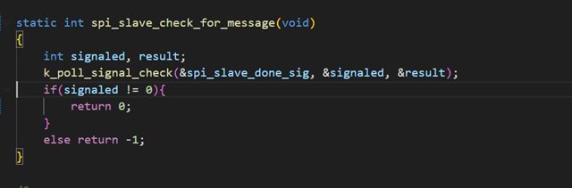

    static int spi_slave_check_for_message(void)
    	int signaled, result;
    	k_poll_signal_check(&spi_slave_done_sig, &signaled, &result);
    	if(signaled != 0){
    		return 0;
    	else return -1;

    GPIOs P0.09 and P0.10 are by default assigned to the NFCT peripherals, as these are the dedicated antenna pins. To use these as GPIOs, you need to configure this in your devicetree:
    &uicr {
        nfct-pins-as-gpios;
    Jørgen
  • Hi
    i added &uicr in my devicetree but still the control not comes to spi_slave_write_test_msg() function
    signaled value is 0 always
    did i configure  pinctrl.dtsi file  correct?
    did you find anything wrong in code ?
