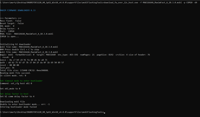

 • Drag and drop the “MRD220 MAX32630 Host FW x˙x˙x ASCII.bin” file in the msbl flashing tools software package onto the DAPLINK drive. The LED on the MAX32625PICO started blinking as it programs the MAX32630FTHR for around 20seconds. The .bin file I used is the one found in the folder "MAXREFDES220_HR_SpO2_Win10_v4.0.0" downloaded from Analog Device WebSite.
• The pins of MAX32664 and MAX32630FTHR have been connected (P3_5 to SLAVE_SCL, P3_4 to SLAVE_SDA, P5_6 to RSTN, P5_4 to MFIO, GND to GND, 3v3 volt to VDD of the custom PCB (which through a voltage regulator brings 1.8V to the sensor hub).
•  Re-connect the MAX32630FTHR to the PC (Windows)
• Opened a command prompt in the directory where there are the executable (“download fw over i2c host.exe” , found in the folder "MAXREFDES220_HR_SpO2_Win10_v4.0.0" downloaded from Analog Device WebSite) and the .msbl ("MAX32664A_MaximFast_A_10.3.0" found in the  "MAX32664A_HR_SpO2_v10.3.0_(1)" folder downloaded from Analog Device, searching for MAx32664 product).
The last passage gives error: "unable to enter bootloader mode, err... -1"

  • I am using nRF5_SDK_17.1.0_ddde560. When i download (via SWD from nrf52DK to my custom board) the code (written in SES) to enter bootloader (raising and lowering MFIO/RSTN), it works: I see the LED turning on / off according to the MAX32664 answer.
    But, since I need to update the firmware of the sensor hub to use my code, I am trying doing it by using MAX32630FTHR. Doing it, following the steps I described before, I do not get a response from the sensor hub: In particular, this is what I have in the command prompt

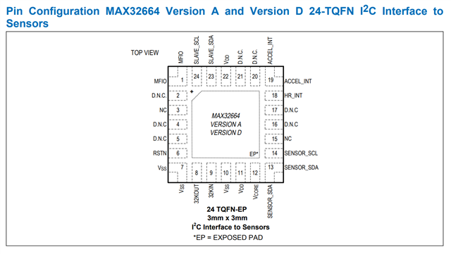

    SLAVE_SCL is connected to pin 24, SLAVE_SDA to 23 as from datasheet. Moreover, there are pull up resistors (4.7 kOhm).
    The error comes from:
        ######### Bootloader #########
        def bootloader_single_download(self, reset):
            print('\nDownloading msbl file')
            if self.enter_bootloader_mode() != 0:
                print('Entering bootloader mode failed')
                return
        def enter_bootloader_mode(self):
            ret = self.send_str_cmd('bootldr\n')
            if ret[0] != 0:
                print('Unable to enter bootloader mode... err: ' + str(ret[0]))
            return ret[0]
        def send_str_cmd(self, cmd):
            length = 0;
            self.ser.write(cmd.encode())
            return self.parse_response(cmd.encode())
  • Moreover, I tried, by connecting nrf52-dk to my custom pcb via SWD: to set high / low mfio/rstn and it does it properly; and also to use twi_scanner example and it finds properly the sensors. So my deduction was that everything is properly connected and working
