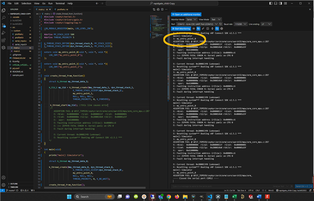

k_thread_create() from a function?

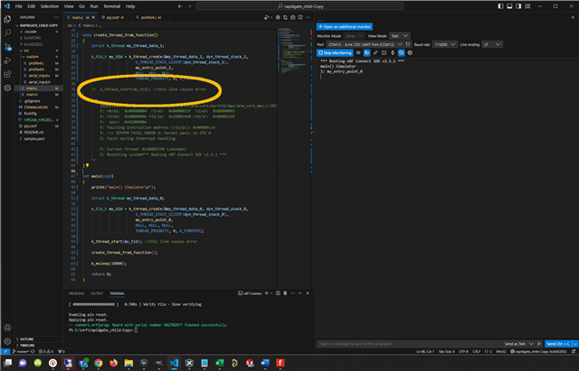

Edit: evidently "struct k_thread my_thread_data_1;" has to be defined outside of the function? That seems to solve the problem, although "struct k_thread my_thread_data_0;" works inside main()... If that is correct, then I solved the problem but I am surprised "struct k_thread" can be defined both inside and outside of a function, sometimes work and sometimes not?
I am able to create and start a thread from main(), but when I start a identical thread from a function I get an error?
It seems happy to create the thread in the function as long as I don't start it.

        ASSERTION FAIL @ WEST_TOPDIR/zephyr/arch/arm/core/aarch32/mpu/arm_core_mpu.c:287
        E: r0/a1:  0x00000004  r1/a2:  0x0000011f  r2/a3:  0x00000001
        E: r3/a4:  0x0000000e r12/ip:  0x200014b0 r14/lr:  0x00001d3f
        E:  xpsr:  0x6100000e
        E: Faulting instruction address (r15/pc): 0x00009cc6
        E: >>> ZEPHYR FATAL ERROR 4: Kernel panic on CPU 0
        E: Fault during interrupt handling
        E: Current thread: 0x200013f0 (unknown)
        E: Resetting system*** Booting nRF Connect SDK v2.5.1 ***

void create_thread_from_function()
	k_tid_t my_tid = k_thread_create(&my_thread_data_1, dyn_thread_stack_1,
						K_THREAD_STACK_SIZEOF(dyn_thread_stack_1),
						my_entry_point_1,
						NULL, NULL, NULL,
						THREAD_PRIORITY, 0, K_FOREVER);
	 k_thread_start(my_tid); //this line causes error
		E:  xpsr:  0x6100000e
	printk("main() Simulator\n");
	k_thread_create(&my_thread_data_0, dyn_thread_stack_0,
						K_THREAD_STACK_SIZEOF(dyn_thread_stack_0),
						my_entry_point_0,
						NULL, NULL, NULL,
						THREAD_PRIORITY, 0, K_NO_WAIT);
	create_thread_from_function();
	k_msleep(10000);
