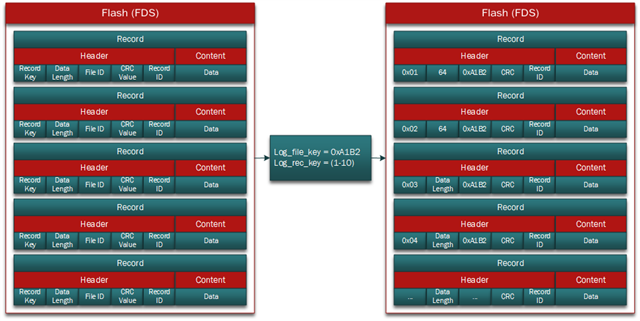

    Since I can't reserve a specific size, I'm wondering if maybe I can reserve a certain number of records instead.
    For example, for wear leveling, let's say I reserve ten records for logging; each record will have a unique record key, 1-10, and share the same file ID.
    Kind of something like this:
    The logic for those ten slots would be the following:
    • If a log already exists in one of the ten records, then the "occurrence count" for that specific log is incremented and the existing log will be updated.
    • If the log doesn't exist, and one of the ten records is available, then the new log will be written. This process continues until all ten records are filled.
    • If all ten slots are filled with unique logs, and a new log that does not exist comes in, then it will be dropped.
    I know this is purely an implementation question, but I'm curious if FDS would allow for a paradigm like this.
    Also, I say "wear leveling," but I haven't convinced myself that I am using that term correctly. Mainly because an FDS update is really still a write, and I think it invalidates the previous record. So, the FDS design I mentioned about reserving ten records might not actually save me anything.
    Again, I know this is more of an implementation question, but can you confirm if I am on the right track?
