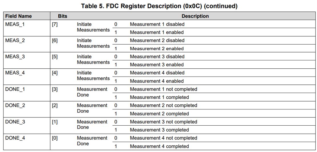

    The plots refer to a I2C read request (isMeasDone() function) to the register FDC_CONF (address 0x0C) of the FDC1004 device (I2C address 0x50). The register is structured as follows:
    The configuration of this register just before the "isMeasDone()" function is: 100Sample/s, Repeat Meas enabled,  MEAS_1 Initiate measurement enabled.

  • Here i am with new developments,
    At first, i understood why the I2C packets were messed up. This was my fault when, trying to fix my issue, i used a function "fdc1004_reset()" to reset the device just before setting up the acquisition parameters. Because i didn't wait for the device to fully reset, the device was not ready to set the acquisition parameters. After this fix, this is what i obtain from I2C analysis when i run the "isMeasDone()"  function:
    Everything is how it should be, with the exception of the "guilty" bit in the last byte, that should be 0x88 and not 0x80.

    - I studied the TCS3400 breakout and i discovered that there is an I2C EEPROM together with the TCS3400 sensor. Based on the breakout schematic that i found out on the AMS website, the EEPROM I2C address is 0xA0, so it should not create issues.
    - I noticed something that i want to remark, even if it could just be me being insanely suspicious. If you  zoom in the "TCS3400 plugged in" plot on the part where the "1" bit is missing, this is what you see
    In the very same spot where the bit should be "1", there is a very small bump (about 30-40 mV), exacty 1-clock cycle wide. I have no idea why it is like this and if it can be any relevant, but it's exactly where the "1" should be.
    Share your thoughts with me Slight smile
    Thank you
    Frax
  • Need spec on the e2 (EEPROM):
    "The seven bit address for the FDC1004 is (MSB first): b101 0000." which happens to be 0xA0 for a write, and 0xA1 for a read; highly suspicious .. "the EEPROM I2C address is 0xA0"
