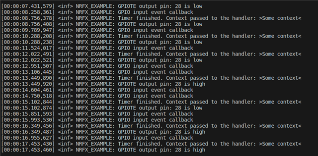

But what happens is that the input pin trigger the timer to start and the timer stops itself but the output pin isn't changing.
The response from the DK:
[00:00:00.422,607] <inf> NRFX_EXAMPLE: Starting nrfx_gppi basic one-to-one example.
[00:00:00.430,694] <inf> NRFX_EXAMPLE: GPIOTE status: initialized
[00:00:00.430,725] <inf> NRFX_EXAMPLE: Time to wait: 1000 ms
[00:00:06.158,020] <inf> NRFX_EXAMPLE: GPIO input event callback
[00:00:07.158,325] <inf> NRFX_EXAMPLE: Timer finished. Context passed to the handler: >Some context<
[00:00:07.158,355] <inf> NRFX_EXAMPLE: GPIOTE output pin: 28 is high
[00:00:16.346,740] <inf> NRFX_EXAMPLE: GPIO input event callback
[00:00:16.586,303] <inf> NRFX_EXAMPLE: GPIO input event callback
[00:00:16.587,127] <inf> NRFX_EXAMPLE: GPIO input event callback
[00:00:17.347,320] <inf> NRFX_EXAMPLE: Timer finished. Context passed to the handler: >Some context<
[00:00:17.347,351] <inf> NRFX_EXAMPLE: GPIOTE output pin: 28 is high

Also I noticed that the Input is triggered multiple times from the push button, is this related to the button bouncing?

  • Hello Basem,
    Are you able to share the rest of your project? That might help me understand why it's failing.
    Most likely. There is no HW debouncing filter on the board.
    Vidar

    Best Regards,
    Basem
  • Hello Basem,
    This is more than refactoring. That said, I've copied and pasted your code into the one-to-one project but was unable to replicate the issue you encountered. Could you please try to program the zephyr.hex file included in the attached zip to see if you encounter the same problem?
    one_to_one_test.zip

    And it seems to be behave as I expected but when the timer is configured for (500 ms) and connecting the input pin with the on-board button 1 and the output pin with the on-board led 1.
    But when I configure the timer with e.g. (5 ms) and connect the input pin with the zero-crossing circuit, and the output pin with the circuit, and a common ground, the behavior changes, and it seems that the zero-crossing signal doesn't trigger the input pin to enable the timer nor affect the output pin (while I still using the pins connected to the on-board led 1 and button 1).
    It seems that the GPIO pin isn't responding because it burnt out, so that the timer wasn't triggered.
    Is it possible for one GPIO pin to be burnt but the other GPIOs and the whole DK is still working?
    Is there a way to recover this GPIO pin?
    I've tried to simulate the zero-crossing signal by generating it using another DK using Timer, and tested my code and it seems to behave as I expect. The HW team will revise the dimmer circuit design and retest again after verifying that it free of problems.
    I'm not understand exactly what do you mean by that?
