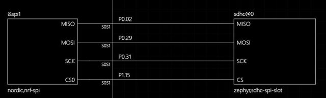

    How is the SD card connected to the dongle? It looks like one of the default pins for spi1 node for nrf52840dongle_nrf52840 target (P0.30) is not mapped out to any pin on the dongle. I could not see any pin changes in your overlay file, but the compiled dts file (build/zephyr/zephyr.dts) suggests you have changed this somewhere. Have you modified the board files in Zephyr directly?

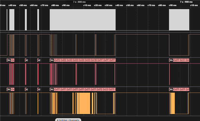

    I seems odd to me that there might be a hardware or low-level problem with the SD card, given that the code correctly identifies the SD card size and free space.

    1) I have indeed put my logic analyzer on the SD card lines, everything looks good, all the traces are moving up and down. Here is an image of the capture, from top to bottom the traces are clock, CS, MOSI, MISO.
