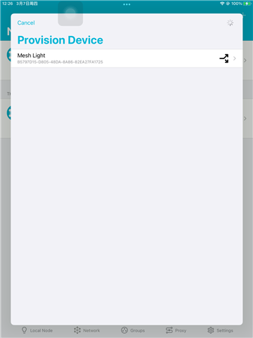

  • Hi
    I modified the Light Dimmer sample program following your instructions to enable the PRP Server, and provisioned it using the nRF Mesh app. However, when I was about to add a new unprovisioned device(Mesh Light), and clicked on the "Mesh Light" item, the APP crashed. I don't know where the problem lies.
    Are the "different icons" you mentioned the "bifurcated arrow" on the right side of the item in the picture?
    Yes, that arrow symbol indicates remote provisioning is available for that node. Selecting it in the list should give you remote provisioning as a provisioning option.
    Please ensure you have the latest version of the app, and if it still fails can you share the log? A log from the device itself may also be of help.

    1. When operating with an iPad tablet, the nRF Mesh crashed.

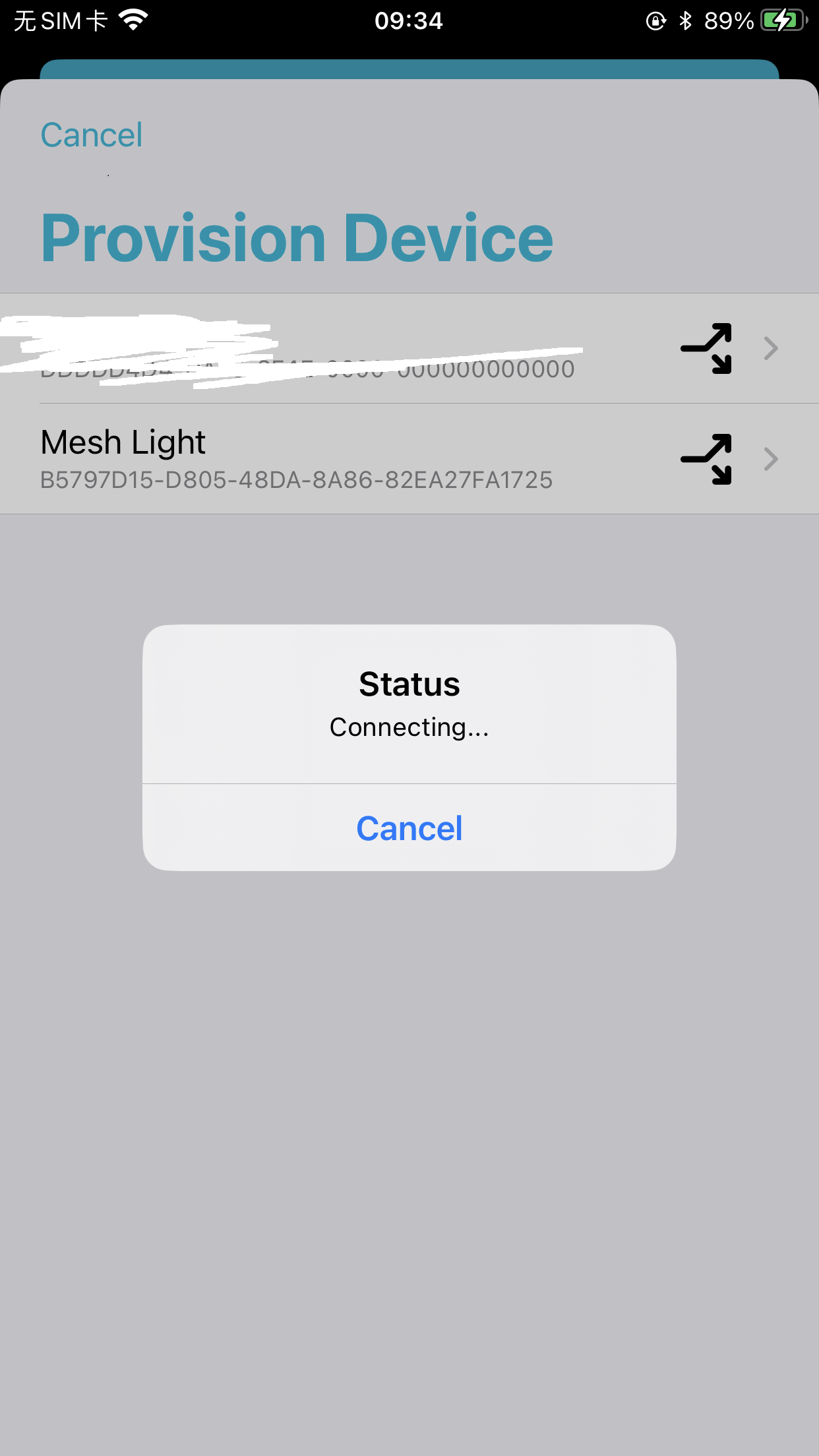

    (2) It stops at the provision device page and remains in the "connecting" status. The relevant LOG is in the "fail+log.h" file.

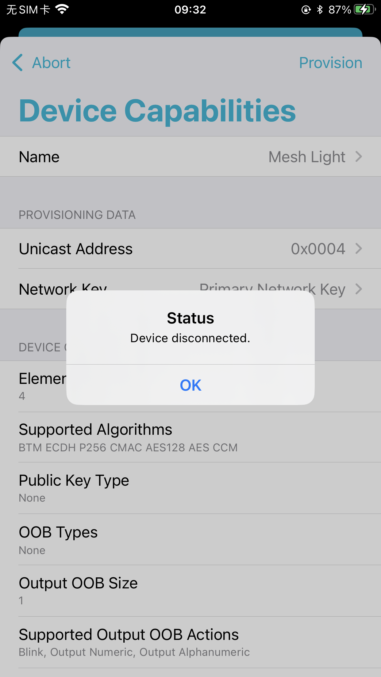

    (3) After entering the device capabilities page,click the "provisioning" button. it remains in the "connecting" state for a long time, and then changes to the "device disconnected" status. The relevant LOG is in the "fail+log2.h" file.
