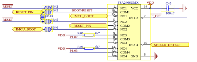

Regarding the nRF5340 DK on the use of these I2C pins:
The I2C/TWI/TWIM pins are not just connected to the user nRF5340 but also to the interface nRF5340; we have no idea what that does and no way to isolate these pins from the interface nRF5340. Does the Interface nRF5340 impact operation on the I2C in any way?
User nRF5340 U1        Interface nRF5340 U2 Arduino Board            On-board Pull-ups        Connectors
U1 P1.02 AE1 P1.02/I2C U2 P1.02 AE1         via 0R0 R20 to P1.02 SDA R48 4k7 PU via U6 switch P10 pin  9  P4 pin  9  P16 pin 18
U1 P1.03 AF2 P1.03/I2C U2 P1.03 AF2         via 0R0 R24 to P1.03 SCL R49 4k7 PU via U6 switch P10 pin 10  P4 pin 10  P16 pin 20
