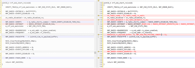

My project is based on the  examples\proprietary_rf\esb_low_power_prx\pca10056\blank\arm5_no_packs, and modifications have been made with reference to https://devzone.nordicsemi.com/f/nordic-q-a/32481/device-match/133989,  and NRF_ESB_MAX_PAYLOAD_LENGTH = 64 with dynamic payload length.
I have encountered a issue.
When packet length increase in transmitter, not every length can communicate successfully. And success and failure  take turns occurring.
eg.
NRF_RADIO->DACNF|= (1U << (pipe + RADIO_DACNF_TXADD0_Pos)),
length in nrf_esb_payload_t is 15 Byte or 16Byte,  receiver can receive this message, but  length in nrf_esb_payload_t is 17 Byte or 18Byte, failed.
19,20Byte success,and 21 22failed .....
and NRF_RADIO->DACNF|= (0U << (pipe + RADIO_DACNF_TXADD0_Pos)),
length in nrf_esb_payload_t is 15 Byte or 16Byte,  receiver cannot receive this message, but  length in nrf_esb_payload_t is 17 Byte or 18Byte, success.
19,20Byte failed,and 21, 22Byte success .....
Hope someone can help me.
52833,SDK 17.
    Not sure I understand, I took the two examples:
    nRF5_SDK_17.1.0_ddde560\examples\proprietary_rf\esb_low_power_ptx
    nRF5_SDK_17.1.0_ddde560\examples\proprietary_rf\esb_low_power_prx
    I changed NRF_ESB_MAX_PAYLOAD_LENGTH to 64.
    Then I tried with different payload lengths on the transmitter by simply trying various tx_payload.length before calling nrf_esb_write_payload(). I am not able to make it fail:
    What changes are you doing?
    Edit: I notice you have modifed DACNF register here, please be aware of the statement in the datasheet:
    https://infocenter.nordicsemi.com/topic/ps_nrf52833/radio.html#concept_s3y_z2j_4r
    "The device address match feature is tailored for address whitelisting in Bluetooth low energy and similar implementations." So it's not tested or intended to work with ESB.
    Kenneth
  • static void update_rf_payload_format_esb_dpl(uint32_t payload_length)
    #if (NRF_ESB_MAX_PAYLOAD_LENGTH <= 32)
        // Using 6 bits for length
        NRF_RADIO->PCNF0 = (1 << RADIO_PCNF0_S0LEN_Pos) |
                           (6 << RADIO_PCNF0_LFLEN_Pos) |
                           (3 << RADIO_PCNF0_S1LEN_Pos) ;
    #else
        // Using 8 bits for length
                           (8 << RADIO_PCNF0_LFLEN_Pos) |
        NRF_RADIO->PCNF1 = (RADIO_PCNF1_WHITEEN_Enabled << RADIO_PCNF1_WHITEEN_Pos) |
                           (RADIO_PCNF1_ENDIAN_Little << RADIO_PCNF1_ENDIAN_Pos) |
                           ((m_wukong_addr.addr_length - 1) << RADIO_PCNF1_BALEN_Pos) |
                           (0 << RADIO_PCNF1_STATLEN_Pos) |
                           (MG_WUKONG_MAX_PAYLOAD_LENGTH << RADIO_PCNF1_MAXLEN_Pos);
    void mg_wukong_whitelist_add(uint8_t pipe, const uint8_t *addr)
        if (MG_WUKONG_MODE_MTX == m_config_local.mode)
            return;
        NRF_RADIO->DAP[pipe] = ((((uint16_t)addr[5]) << 8)
                                | (((uint16_t)addr[4])));
        NRF_RADIO->DAB[pipe] = ((((uint32_t)addr[3]) << 24)
                                | (((uint32_t)addr[2]) << 16)
                                | (((uint32_t)addr[1]) << 8)
                                | (((uint32_t)addr[0])));
        NRF_RADIO->DACNF |= (1U << (pipe + RADIO_DACNF_TXADD0_Pos));
        NRF_RADIO->DACNF |= (1U << pipe);
    #ifdef NRF52832_XXAA ==> #ifdef   1
    I marked what I thought was the key difference.
    Or, Based on the lastest answer's  nrf_esb.c  in https://devzone.nordicsemi.com/f/nordic-q-a/32481/device-match/133989  ,could you provide me new examples(esb_low_power_ptx and esb_low_power_prx) on sdk17.0.2 .
    this is the file nrf_esb.c in https://devzone.nordicsemi.com/f/nordic-q-a/32481/device-match/133989

    static uint32_t addr_conv(uint8_t const* p_addr)
        return __REV(bytewise_bit_swap(p_addr)); //lint -esym(628, __rev) -esym(526, __rev) */
    static ret_code_t apply_address_workarounds()
    #ifdef NRF52
        //  Set up radio parameters.
        NRF_RADIO->MODECNF0 = (NRF_RADIO->MODECNF0 & ~RADIO_MODECNF0_RU_Msk) | RADIO_MODECNF0_RU_Default << RADIO_MODECNF0_RU_Pos;
        // Workaround for nRF52832 Rev 1 Errata 102 and nRF52832 Rev 1 Errata 106. This will reduce sensitivity by 3dB.
        *((volatile uint32_t *)0x40001774) = (*((volatile uint32_t *)0x40001774) & 0xFFFFFFFE) | 0x01000000;
        return NRF_SUCCESS;
        NRF_RADIO->PCNF0 = (1 << RADIO_PCNF0_S0LEN_Pos) |  //Setting 1 for S0 byte
    #else
        NRF_RADIO->PCNF1 = (RADIO_PCNF1_WHITEEN_Disabled    << RADIO_PCNF1_WHITEEN_Pos) |
                           ((m_esb_addr.addr_length - 1)    << RADIO_PCNF1_BALEN_Pos)   |
                           (NRF_ESB_MAX_PAYLOAD_LENGTH      << RADIO_PCNF1_MAXLEN_Pos);
    static void update_rf_payload_format_esb(uint32_t payload_length)
                           (0 << RADIO_PCNF0_LFLEN_Pos) |
                           (1 << RADIO_PCNF0_S1LEN_Pos);
                           (payload_length                  << RADIO_PCNF1_STATLEN_Pos) |
                           (payload_length                  << RADIO_PCNF1_MAXLEN_Pos);
    static void update_radio_addresses(uint8_t update_mask)
        if ((update_mask & NRF_ESB_ADDR_UPDATE_MASK_BASE0) != 0)
            NRF_RADIO->BASE0 = addr_conv(m_esb_addr.base_addr_p0);
        if ((update_mask & NRF_ESB_ADDR_UPDATE_MASK_BASE1) != 0)
            NRF_RADIO->BASE1 = addr_conv(m_esb_addr.base_addr_p1);
        if ((update_mask & NRF_ESB_ADDR_UPDATE_MASK_PREFIX) != 0)
            NRF_RADIO->PREFIX0 = bytewise_bit_swap(&m_esb_addr.pipe_prefixes[0]);
            NRF_RADIO->PREFIX1 = bytewise_bit_swap(&m_esb_addr.pipe_prefixes[4]);
    static void update_radio_tx_power()
        NRF_RADIO->TXPOWER = m_config_local.tx_output_power << RADIO_TXPOWER_TXPOWER_Pos;
    static bool update_radio_bitrate()
        NRF_RADIO->MODE = m_config_local.bitrate << RADIO_MODE_MODE_Pos;
        switch (m_config_local.bitrate)
            case NRF_ESB_BITRATE_2MBPS:
    #ifdef NRF52
            case NRF_ESB_BITRATE_2MBPS_BLE:
                m_wait_for_ack_timeout_us = RX_WAIT_FOR_ACK_TIMEOUT_US_2MBPS;
            case NRF_ESB_BITRATE_1MBPS:
                m_wait_for_ack_timeout_us = RX_WAIT_FOR_ACK_TIMEOUT_US_1MBPS;
    #ifdef NRF51
            case NRF_ESB_BITRATE_250KBPS:
                m_wait_for_ack_timeout_us = RX_WAIT_FOR_ACK_TIMEOUT_US_250KBPS;
            case NRF_ESB_BITRATE_1MBPS_BLE:
                m_wait_for_ack_timeout_us = RX_WAIT_FOR_ACK_TIMEOUT_US_1MBPS_BLE;
            default:
                // Should not be reached
                return false;
        return true;
    static bool update_radio_protocol()
        switch (m_config_local.protocol)
            case NRF_ESB_PROTOCOL_ESB_DPL:
                update_rf_payload_format = update_rf_payload_format_esb_dpl;
            case NRF_ESB_PROTOCOL_ESB:
                update_rf_payload_format = update_rf_payload_format_esb;
            default:
                return false;
        return true;
    static bool update_radio_crc()
        switch(m_config_local.crc)
            case NRF_ESB_CRC_16BIT:
                NRF_RADIO->CRCINIT = 0xFFFFUL;      // Initial value
                NRF_RADIO->CRCPOLY = 0x11021UL;     // CRC poly: x^16+x^12^x^5+1
            case NRF_ESB_CRC_8BIT:
                NRF_RADIO->CRCINIT = 0xFFUL;        // Initial value
                NRF_RADIO->CRCPOLY = 0x107UL;       // CRC poly: x^8+x^2^x^1+1
            case NRF_ESB_CRC_OFF:
            default:
                return false;
        NRF_RADIO->CRCCNF = m_config_local.crc << RADIO_CRCCNF_LEN_Pos;
        return true;
    static bool update_radio_parameters()
        bool params_valid = true;
        update_radio_tx_power();
        params_valid &= update_radio_bitrate();
        params_valid &= update_radio_protocol();
        params_valid &= update_radio_crc();
        update_rf_payload_format(m_config_local.payload_length);
        params_valid &= (m_config_local.retransmit_delay >= NRF_ESB_RETRANSMIT_DELAY_MIN);
        return params_valid;
    static void reset_fifos()
        m_tx_fifo.entry_point = 0;
        m_tx_fifo.exit_point  = 0;
        m_tx_fifo.count       = 0;
        m_rx_fifo.entry_point = 0;
        m_rx_fifo.exit_point  = 0;
        m_rx_fifo.count       = 0;
    static void initialize_fifos()
        reset_fifos();
        for (int i = 0; i < NRF_ESB_TX_FIFO_SIZE; i++)
            m_tx_fifo.p_payload[i] = &m_tx_fifo_payload[i];
        for (int i = 0; i < NRF_ESB_RX_FIFO_SIZE; i++)
            m_rx_fifo.p_payload[i] = &m_rx_fifo_payload[i];
    static void tx_fifo_remove_last()
        if (m_tx_fifo.count > 0)
            DISABLE_RF_IRQ();
            m_tx_fifo.count--;
            if (++m_tx_fifo.exit_point >= NRF_ESB_TX_FIFO_SIZE)
            ENABLE_RF_IRQ();
    /** @brief  Function to push the content of the rx_buffer to the RX FIFO.
     *  The module will point the register NRF_RADIO->PACKETPTR to a buffer for receiving packets.
     *  After receiving a packet the module will call this function to copy the received data to
     *  the RX FIFO.
     *  @param  pipe Pipe number to set for the packet.
     *  @param  pid  Packet ID.
     *  @retval true   Operation successful.
     *  @retval false  Operation failed.
    static bool rx_fifo_push_rfbuf(uint8_t pipe, uint8_t pid)
        if (m_rx_fifo.count < NRF_ESB_RX_FIFO_SIZE)
            if (m_config_local.protocol == NRF_ESB_PROTOCOL_ESB_DPL)
                if (m_rx_payload_buffer[1] > NRF_ESB_MAX_PAYLOAD_LENGTH) //Moved 1 byte. Changed from 0 to 1.
                    return false;
                m_rx_fifo.p_payload[m_rx_fifo.entry_point]->length = m_rx_payload_buffer[1]; //Length is moved 1 byte because of S0. Changed from 0 to 1
            else if (m_config_local.mode == NRF_ESB_MODE_PTX)
                // Received packet is an acknowledgment
                m_rx_fifo.p_payload[m_rx_fifo.entry_point]->length = 0;
            else
                m_rx_fifo.p_payload[m_rx_fifo.entry_point]->length = m_config_local.payload_length;
            memcpy(m_rx_fifo.p_payload[m_rx_fifo.entry_point]->data, &m_rx_payload_buffer[3], //Moved 1 byte. Changed from 2 to 3.
                   m_rx_fifo.p_payload[m_rx_fifo.entry_point]->length);
            m_rx_fifo.p_payload[m_rx_fifo.entry_point]->pipe  = pipe;
            m_rx_fifo.p_payload[m_rx_fifo.entry_point]->rssi  = NRF_RADIO->RSSISAMPLE;
            m_rx_fifo.p_payload[m_rx_fifo.entry_point]->pid   = pid;
            m_rx_fifo.p_payload[m_rx_fifo.entry_point]->noack = !(m_rx_payload_buffer[2] & 0x01);  //moved 1 byte. Changed from 1 to 2.
            if (++m_rx_fifo.entry_point >= NRF_ESB_RX_FIFO_SIZE)
            m_rx_fifo.count++;
            return true;
        return false;
    static void sys_timer_init()
        // Configure the system timer with a 1 MHz base frequency
        NRF_ESB_SYS_TIMER->PRESCALER = 4;
        NRF_ESB_SYS_TIMER->BITMODE   = TIMER_BITMODE_BITMODE_16Bit;
        NRF_ESB_SYS_TIMER->SHORTS    = TIMER_SHORTS_COMPARE1_CLEAR_Msk | TIMER_SHORTS_COMPARE1_STOP_Msk;
    static void ppi_init()
        NRF_PPI->CH[NRF_ESB_PPI_TIMER_START].EEP = (uint32_t)&NRF_RADIO->EVENTS_READY;
        NRF_PPI->CH[NRF_ESB_PPI_TIMER_START].TEP = (uint32_t)&NRF_ESB_SYS_TIMER->TASKS_START;
        NRF_PPI->CH[NRF_ESB_PPI_TIMER_STOP].EEP  = (uint32_t)&NRF_RADIO->EVENTS_ADDRESS;
        NRF_PPI->CH[NRF_ESB_PPI_TIMER_STOP].TEP  = (uint32_t)&NRF_ESB_SYS_TIMER->TASKS_STOP;
        NRF_PPI->CH[NRF_ESB_PPI_RX_TIMEOUT].EEP  = (uint32_t)&NRF_ESB_SYS_TIMER->EVENTS_COMPARE[0];
        NRF_PPI->CH[NRF_ESB_PPI_RX_TIMEOUT].TEP  = (uint32_t)&NRF_RADIO->TASKS_DISABLE;
        NRF_PPI->CH[NRF_ESB_PPI_TX_START].EEP    = (uint32_t)&NRF_ESB_SYS_TIMER->EVENTS_COMPARE[1];
        NRF_PPI->CH[NRF_ESB_PPI_TX_START].TEP    = (uint32_t)&NRF_RADIO->TASKS_TXEN;
    static void start_tx_transaction()
        bool ack;
        m_last_tx_attempts = 1;
        // Prepare the payload
        mp_current_payload = m_tx_fifo.p_payload[m_tx_fifo.exit_point];
            case NRF_ESB_PROTOCOL_ESB: //We are using ESB_DPL. No changes done here.
                update_rf_payload_format(mp_current_payload->length);
                m_tx_payload_buffer[0] = mp_current_payload->pid;
                m_tx_payload_buffer[1] = 0;
                memcpy(&m_tx_payload_buffer[2], mp_current_payload->data, mp_current_payload->length);
                NRF_RADIO->SHORTS   = m_radio_shorts_common | RADIO_SHORTS_DISABLED_RXEN_Msk;
                NRF_RADIO->INTENSET = RADIO_INTENSET_DISABLED_Msk | RADIO_INTENSET_READY_Msk;
                // Configure the retransmit counter
                m_retransmits_remaining = m_config_local.retransmit_count;
                on_radio_disabled = on_radio_disabled_tx;
                m_nrf_esb_mainstate = NRF_ESB_STATE_PTX_TX_ACK;
                ack = !mp_current_payload->noack || !m_config_local.selective_auto_ack;
    	    m_tx_payload_buffer[0] = S0BYTE; //setting s0 as first byte in packet.
                m_tx_payload_buffer[1] = mp_current_payload->length; //Length has been moved 1 byte. Changed from 0 to 1.
                m_tx_payload_buffer[2] = mp_current_payload->pid << 1;  //Moved 1 byte. Changed from 1 to 2.
                m_tx_payload_buffer[2] |= mp_current_payload->noack ? 0x00 : 0x01; //Moved 1 byte. Changed from 1 to 2.
                memcpy(&m_tx_payload_buffer[3], mp_current_payload->data, mp_current_payload->length); //Moved 1 byte. Changed from 2 to 3.
                // Handling ack if noack is set to false or if selective auto ack is turned off
                if (ack)
                else
                    NRF_RADIO->SHORTS   = m_radio_shorts_common;
                    NRF_RADIO->INTENSET = RADIO_INTENSET_DISABLED_Msk;
                    on_radio_disabled   = on_radio_disabled_tx_noack;
                    m_nrf_esb_mainstate = NRF_ESB_STATE_PTX_TX;
            default:
        NRF_RADIO->TXADDRESS    = mp_current_payload->pipe;
        NRF_RADIO->RXADDRESSES  = 1 << mp_current_payload->pipe;
        NRF_RADIO->FREQUENCY    = m_esb_addr.rf_channel;
        NRF_RADIO->PACKETPTR    = (uint32_t)m_tx_payload_buffer;
        NVIC_ClearPendingIRQ(RADIO_IRQn);
        NVIC_EnableIRQ(RADIO_IRQn);
        NRF_RADIO->EVENTS_ADDRESS = 0;
        NRF_RADIO->EVENTS_PAYLOAD = 0;
        NRF_RADIO->EVENTS_DISABLED = 0;
        DEBUG_PIN_SET(DEBUGPIN4);
        NRF_RADIO->TASKS_TXEN  = 1;
    static void on_radio_disabled_tx_noack()
        m_interrupt_flags |= NRF_ESB_INT_TX_SUCCESS_MSK;
        tx_fifo_remove_last();
        if (m_tx_fifo.count == 0)
            m_nrf_esb_mainstate = NRF_ESB_STATE_IDLE;
            NVIC_SetPendingIRQ(ESB_EVT_IRQ);
        else
            start_tx_transaction();
    static void on_radio_disabled_tx()
        // Remove the DISABLED -> RXEN shortcut, to make sure the radio stays
        // disabled after the RX window
        // Make sure the timer is started the next time the radio is ready,
        // and that it will disable the radio automatically if no packet is
        // received by the time defined in m_wait_for_ack_timeout_us
        NRF_ESB_SYS_TIMER->CC[0]    = m_wait_for_ack_timeout_us;
        NRF_ESB_SYS_TIMER->CC[1]    = m_config_local.retransmit_delay - 130;
        NRF_ESB_SYS_TIMER->TASKS_CLEAR = 1;
        NRF_ESB_SYS_TIMER->EVENTS_COMPARE[0] = 0;
        NRF_ESB_SYS_TIMER->EVENTS_COMPARE[1] = 0;
        NRF_PPI->CHENSET            = (1 << NRF_ESB_PPI_TIMER_START) |
                                      (1 << NRF_ESB_PPI_RX_TIMEOUT) |
                                      (1 << NRF_ESB_PPI_TIMER_STOP);
        NRF_PPI->CHENCLR            = (1 << NRF_ESB_PPI_TX_START);
        NRF_RADIO->EVENTS_END       = 0;
        if (m_config_local.protocol == NRF_ESB_PROTOCOL_ESB)
            update_rf_payload_format(0);
        NRF_RADIO->PACKETPTR        = (uint32_t)m_rx_payload_buffer;
        on_radio_disabled           = on_radio_disabled_tx_wait_for_ack;
        m_nrf_esb_mainstate         = NRF_ESB_STATE_PTX_RX_ACK;
    static void on_radio_disabled_tx_wait_for_ack()
        // This marks the completion of a TX_RX sequence (TX with ACK)
        // Make sure the timer will not deactivate the radio if a packet is received
        NRF_PPI->CHENCLR = (1 << NRF_ESB_PPI_TIMER_START) |
        // If the radio has received a packet and the CRC status is OK
        if (NRF_RADIO->EVENTS_END && NRF_RADIO->CRCSTATUS != 0)
            NRF_ESB_SYS_TIMER->TASKS_STOP = 1;
            m_last_tx_attempts = m_config_local.retransmit_count - m_retransmits_remaining + 1;
            if (m_config_local.protocol != NRF_ESB_PROTOCOL_ESB && m_rx_payload_buffer[0] > 0)
                if (rx_fifo_push_rfbuf((uint8_t)NRF_RADIO->TXADDRESS, m_rx_payload_buffer[1] >> 1))
                    m_interrupt_flags |= NRF_ESB_INT_RX_DATA_RECEIVED_MSK;
            if ((m_tx_fifo.count == 0) || (m_config_local.tx_mode == NRF_ESB_TXMODE_MANUAL))
            else
        else
            if (m_retransmits_remaining-- == 0)
                // All retransmits are expended, and the TX operation is suspended
                m_last_tx_attempts = m_config_local.retransmit_count + 1;
                m_interrupt_flags |= NRF_ESB_INT_TX_FAILED_MSK;
            else
                // There are still more retransmits left, TX mode should be
                // entered again as soon as the system timer reaches CC[1].
                NRF_ESB_SYS_TIMER->TASKS_START = 1;
                NRF_PPI->CHENSET = (1 << NRF_ESB_PPI_TX_START);
                if (NRF_ESB_SYS_TIMER->EVENTS_COMPARE[1])
    static void clear_events_restart_rx(void)
        NRF_RADIO->TASKS_DISABLE = 1;
        while (NRF_RADIO->EVENTS_DISABLED == 0);
        NRF_RADIO->SHORTS = m_radio_shorts_common | RADIO_SHORTS_DISABLED_TXEN_Msk;
        NRF_RADIO->TASKS_RXEN = 1;
    static void on_radio_disabled_rx(void)
        bool            ack                = false;
        bool            retransmit_payload = false;
        bool            send_rx_event      = true;
        pipe_info_t *   p_pipe_info;
        if (NRF_RADIO->CRCSTATUS == 0)
            clear_events_restart_rx();
            return;
        if (m_rx_fifo.count >= NRF_ESB_RX_FIFO_SIZE)
            return;
        p_pipe_info = &m_rx_pipe_info[NRF_RADIO->RXMATCH];
        if (NRF_RADIO->RXCRC             == p_pipe_info->crc &&
            (m_rx_payload_buffer[2] >> 1) == p_pipe_info->pid   //Moved 1 byte. Changed from 1 to 2.
            retransmit_payload = true;
            send_rx_event = false;
        p_pipe_info->pid = m_rx_payload_buffer[2] >> 1;  //Moved 1 byte. Changed from 1 to 2.
        p_pipe_info->crc = NRF_RADIO->RXCRC;
        if ((m_config_local.selective_auto_ack == false) || ((m_rx_payload_buffer[2] & 0x01) == 1)) //Moved 1 byte. Changed from 1 to 2.
            ack = true;
        if (ack)
                        if (m_tx_fifo.count > 0 &&
                            (m_tx_fifo.p_payload[m_tx_fifo.exit_point]->pipe == NRF_RADIO->RXMATCH)
                            // Pipe stays in ACK with payload until TX FIFO is empty
                            // Do not report TX success on first ack payload or retransmit
                            if (p_pipe_info->ack_payload == true && !retransmit_payload)
                                m_tx_fifo.count--;
                                // ACK payloads also require TX_DS
                                // (page 40 of the 'nRF24LE1_Product_Specification_rev1_6.pdf').
                            p_pipe_info->ack_payload = true;
    						m_tx_payload_buffer[0] = S0BYTE; // Setting to S0BYTE
                            m_tx_payload_buffer[1] = mp_current_payload->length;   //Moved 1 byte. Changed from 0 to 1.
                            memcpy(&m_tx_payload_buffer[3],   //Moved 1 byte. Changed from 2 to 3.
                        else
                            p_pipe_info->ack_payload = false;
                            m_tx_payload_buffer[1] = 0; //Moved 1 byte. Changed from 0 to 1.
                        m_tx_payload_buffer[2] = m_rx_payload_buffer[2]; //Moved 1 byte. Changed from 1 to 2.
                case NRF_ESB_PROTOCOL_ESB: //Using DPL. No changes
                        m_tx_payload_buffer[0] = m_rx_payload_buffer[0];
            m_nrf_esb_mainstate = NRF_ESB_STATE_PRX_SEND_ACK;
            NRF_RADIO->TXADDRESS = NRF_RADIO->RXMATCH;
            on_radio_disabled = on_radio_disabled_rx_ack;
        else
        if (send_rx_event)
            // Push the new packet to the RX buffer and trigger a received event if the operation was
            // successful.
            if (rx_fifo_push_rfbuf(NRF_RADIO->RXMATCH, p_pipe_info->pid))
    static void on_radio_disabled_rx_ack(void)
        on_radio_disabled = on_radio_disabled_rx;
        m_nrf_esb_mainstate = NRF_ESB_STATE_PRX;
    /**@brief Function for clearing pending interrupts.
     * @param[in,out]   p_interrupts        Pointer to the value that holds the current interrupts.
     * @retval  NRF_SUCCESS                     If the interrupts were cleared successfully.
     * @retval  NRF_ERROR_NULL                  If the required parameter was NULL.
     * @retval  NRF_INVALID_STATE               If the module is not initialized.
    static uint32_t nrf_esb_get_clear_interrupts(uint32_t * p_interrupts)
        VERIFY_TRUE(m_esb_initialized, NRF_ERROR_INVALID_STATE);
        VERIFY_PARAM_NOT_NULL(p_interrupts);
        DISABLE_RF_IRQ();
        *p_interrupts = m_interrupt_flags;
        m_interrupt_flags = 0;
        ENABLE_RF_IRQ();
        return NRF_SUCCESS;
    void RADIO_IRQHandler()
        if (NRF_RADIO->EVENTS_READY && (NRF_RADIO->INTENSET & RADIO_INTENSET_READY_Msk))
            NRF_RADIO->EVENTS_READY = 0;
            DEBUG_PIN_SET(DEBUGPIN1);
        if (NRF_RADIO->EVENTS_END && (NRF_RADIO->INTENSET & RADIO_INTENSET_END_Msk))
            DEBUG_PIN_SET(DEBUGPIN2);
            // Call the correct on_radio_end function, depending on the current protocol state
            if (on_radio_end)
                on_radio_end();
        if (NRF_RADIO->EVENTS_DISABLED && (NRF_RADIO->INTENSET & RADIO_INTENSET_DISABLED_Msk))
            DEBUG_PIN_SET(DEBUGPIN3);
            // Call the correct on_radio_disable function, depending on the current protocol state
            if (on_radio_disabled)
                on_radio_disabled();
        DEBUG_PIN_CLR(DEBUGPIN1);
        DEBUG_PIN_CLR(DEBUGPIN2);
        DEBUG_PIN_CLR(DEBUGPIN3);
        DEBUG_PIN_CLR(DEBUGPIN4);
    uint32_t nrf_esb_init(nrf_esb_config_t const * p_config)
        uint32_t err_code;
        VERIFY_PARAM_NOT_NULL(p_config);
        if (m_esb_initialized)
            err_code = nrf_esb_disable();
            if (err_code != NRF_SUCCESS)
                return err_code;
        m_event_handler = p_config->event_handler;
        memcpy(&m_config_local, p_config, sizeof(nrf_esb_config_t));
        memset(m_rx_pipe_info, 0, sizeof(m_rx_pipe_info));
        memset(m_pids, 0, sizeof(m_pids));
        VERIFY_TRUE(update_radio_parameters(), NRF_ERROR_INVALID_PARAM);
        // Configure radio address registers according to ESB default values
        NRF_RADIO->BASE0   = 0xE7E7E7E7;
        NRF_RADIO->BASE1   = 0x43434343;
        NRF_RADIO->PREFIX0 = 0x23C343E7;
        NRF_RADIO->PREFIX1 = 0x13E363A3;
        initialize_fifos();
        sys_timer_init();
        ppi_init();
        NVIC_SetPriority(RADIO_IRQn, m_config_local.radio_irq_priority & ESB_IRQ_PRIORITY_MSK);
        NVIC_SetPriority(ESB_EVT_IRQ, m_config_local.event_irq_priority & ESB_IRQ_PRIORITY_MSK);
        NVIC_EnableIRQ(ESB_EVT_IRQ);
    #ifdef NRF52
        if(m_address_hang_fix_enable)
            // Setup a timeout timer to start on an ADDRESS match, and stop on a BCMATCH event.
            // If the BCMATCH event never occurs the CC[0] event will fire, and the timer interrupt will disable the radio to recover.
            m_radio_shorts_common |= RADIO_SHORTS_ADDRESS_BCSTART_Msk;
            NRF_RADIO->BCC = 2;
            NRF_ESB_BUGFIX_TIMER->BITMODE = TIMER_BITMODE_BITMODE_32Bit << TIMER_BITMODE_BITMODE_Pos;
            NRF_ESB_BUGFIX_TIMER->PRESCALER = 4;
            NRF_ESB_BUGFIX_TIMER->CC[0] = 5;
            NRF_ESB_BUGFIX_TIMER->SHORTS = TIMER_SHORTS_COMPARE0_STOP_Msk | TIMER_SHORTS_COMPARE0_CLEAR_Msk;
            NRF_ESB_BUGFIX_TIMER->MODE = TIMER_MODE_MODE_Timer << TIMER_MODE_MODE_Pos;
            NRF_ESB_BUGFIX_TIMER->INTENSET = TIMER_INTENSET_COMPARE0_Msk;
            NRF_ESB_BUGFIX_TIMER->TASKS_CLEAR = 1;
            NVIC_SetPriority(NRF_ESB_BUGFIX_TIMER_IRQn, 5);
            NVIC_EnableIRQ(NRF_ESB_BUGFIX_TIMER_IRQn);
            NRF_PPI->CH[NRF_ESB_PPI_BUGFIX1].EEP = (uint32_t)&NRF_RADIO->EVENTS_ADDRESS;
            NRF_PPI->CH[NRF_ESB_PPI_BUGFIX1].TEP = (uint32_t)&NRF_ESB_BUGFIX_TIMER->TASKS_START;
            NRF_PPI->CH[NRF_ESB_PPI_BUGFIX2].EEP = (uint32_t)&NRF_RADIO->EVENTS_BCMATCH;
            NRF_PPI->CH[NRF_ESB_PPI_BUGFIX2].TEP = (uint32_t)&NRF_ESB_BUGFIX_TIMER->TASKS_STOP;
            NRF_PPI->CH[NRF_ESB_PPI_BUGFIX3].EEP = (uint32_t)&NRF_RADIO->EVENTS_BCMATCH;
            NRF_PPI->CH[NRF_ESB_PPI_BUGFIX3].TEP = (uint32_t)&NRF_ESB_BUGFIX_TIMER->TASKS_CLEAR;
            NRF_PPI->CHENSET = (1 << NRF_ESB_PPI_BUGFIX1) | (1 << NRF_ESB_PPI_BUGFIX2) | (1 << NRF_ESB_PPI_BUGFIX3);
        m_esb_initialized = true;
        return NRF_SUCCESS;
    uint32_t nrf_esb_suspend(void)
        VERIFY_TRUE(m_nrf_esb_mainstate == NRF_ESB_STATE_IDLE, NRF_ERROR_BUSY);
        // Clear PPI
                           (1 << NRF_ESB_PPI_TIMER_STOP)  |
        return NRF_SUCCESS;
    uint32_t nrf_esb_disable(void)
        // Clear PPI
        reset_fifos();
        // Disable the radio
        NVIC_DisableIRQ(ESB_EVT_IRQ);
        NRF_RADIO->SHORTS = RADIO_SHORTS_READY_START_Enabled << RADIO_SHORTS_READY_START_Pos |
                            RADIO_SHORTS_END_DISABLE_Enabled << RADIO_SHORTS_END_DISABLE_Pos;
        return NRF_SUCCESS;
    bool nrf_esb_is_idle(void)
        return m_nrf_esb_mainstate == NRF_ESB_STATE_IDLE;
    void ESB_EVT_IRQHandler(void)
        ret_code_t      err_code;
        uint32_t        interrupts;
        nrf_esb_evt_t   event;
        event.tx_attempts = m_last_tx_attempts;
        err_code = nrf_esb_get_clear_interrupts(&interrupts);
        if (err_code == NRF_SUCCESS && m_event_handler != 0)
            if (interrupts & NRF_ESB_INT_TX_SUCCESS_MSK)
                event.evt_id = NRF_ESB_EVENT_TX_SUCCESS;
                m_event_handler(&event);
            if (interrupts & NRF_ESB_INT_TX_FAILED_MSK)
                event.evt_id = NRF_ESB_EVENT_TX_FAILED;
            if (interrupts & NRF_ESB_INT_RX_DATA_RECEIVED_MSK)
                event.evt_id = NRF_ESB_EVENT_RX_RECEIVED;
    uint32_t nrf_esb_write_payload(nrf_esb_payload_t const * p_payload)
        VERIFY_PARAM_NOT_NULL(p_payload);
        VERIFY_PAYLOAD_LENGTH(p_payload);
        VERIFY_FALSE(m_tx_fifo.count >= NRF_ESB_TX_FIFO_SIZE, NRF_ERROR_NO_MEM);
        VERIFY_TRUE(p_payload->pipe < NRF_ESB_PIPE_COUNT, NRF_ERROR_INVALID_PARAM);
        DISABLE_RF_IRQ();
        memcpy(m_tx_fifo.p_payload[m_tx_fifo.entry_point], p_payload, sizeof(nrf_esb_payload_t));
        m_pids[p_payload->pipe] = (m_pids[p_payload->pipe] + 1) % (NRF_ESB_PID_MAX + 1);
        m_tx_fifo.p_payload[m_tx_fifo.entry_point]->pid = m_pids[p_payload->pipe];
        if (++m_tx_fifo.entry_point >= NRF_ESB_TX_FIFO_SIZE)
        m_tx_fifo.count++;
        ENABLE_RF_IRQ();
        if (m_config_local.mode == NRF_ESB_MODE_PTX &&
            m_config_local.tx_mode == NRF_ESB_TXMODE_AUTO &&
            m_nrf_esb_mainstate == NRF_ESB_STATE_IDLE)
        return NRF_SUCCESS;
    uint32_t nrf_esb_read_rx_payload(nrf_esb_payload_t * p_payload)
        if (m_rx_fifo.count == 0)
            return NRF_ERROR_NOT_FOUND;
        DISABLE_RF_IRQ();
        p_payload->length = m_rx_fifo.p_payload[m_rx_fifo.exit_point]->length;
        p_payload->pipe   = m_rx_fifo.p_payload[m_rx_fifo.exit_point]->pipe;
        p_payload->rssi   = m_rx_fifo.p_payload[m_rx_fifo.exit_point]->rssi;
        p_payload->pid    = m_rx_fifo.p_payload[m_rx_fifo.exit_point]->pid;
        p_payload->noack  = m_rx_fifo.p_payload[m_rx_fifo.exit_point]->noack;
        memcpy(p_payload->data, m_rx_fifo.p_payload[m_rx_fifo.exit_point]->data, p_payload->length);
        if (++m_rx_fifo.exit_point >= NRF_ESB_RX_FIFO_SIZE)
        m_rx_fifo.count--;
        ENABLE_RF_IRQ();
        return NRF_SUCCESS;
    uint32_t nrf_esb_start_tx(void)
            return NRF_ERROR_BUFFER_EMPTY;
        return NRF_SUCCESS;
    uint32_t nrf_esb_start_rx(void)
        NRF_RADIO->INTENCLR = 0xFFFFFFFF;
        NRF_RADIO->RXADDRESSES  = m_esb_addr.rx_pipes_enabled;
        return NRF_SUCCESS;
    uint32_t nrf_esb_stop_rx(void)
        if (m_nrf_esb_mainstate == NRF_ESB_STATE_PRX)
            NRF_RADIO->SHORTS = 0;
            on_radio_disabled = NULL;
            return NRF_SUCCESS;
        return NRF_ESB_ERROR_NOT_IN_RX_MODE;
    uint32_t nrf_esb_flush_tx(void)
        DISABLE_RF_IRQ();
        ENABLE_RF_IRQ();
        return NRF_SUCCESS;
    uint32_t nrf_esb_pop_tx(void)
        VERIFY_TRUE(m_tx_fifo.count > 0, NRF_ERROR_BUFFER_EMPTY);
        DISABLE_RF_IRQ();
        m_tx_fifo.count--;
        ENABLE_RF_IRQ();
        return NRF_SUCCESS;

  • As mentioned the DACNF have only been intended to be used with BLE, and not tested in general for other purposes, so it can some configuration that BLE use that indirectly affect the issue you see. I am not sure if I have good suggestion here than to try various configuration to see how that impact the problem you experience, maybe try 1Mbps instead and possible also try to memory align the transmitted/recevied payload buffer to see if that affect the problem in any way, e.g. using __ALIGN(4)
    Kenneth
    Kenneth
