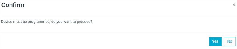

Bootloader mode
when i instead set it into bootloader mode i get the following message:
If i choose No
I get:

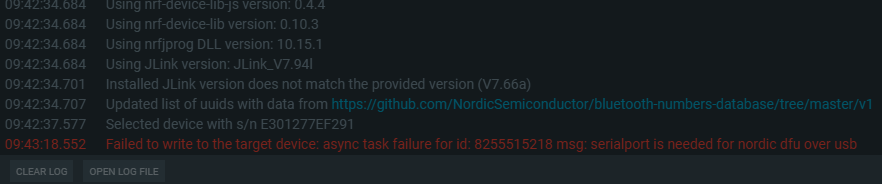

If i choose Yes
It loads forever:
And ouputs the following in the terminal:
As it is loading/frozen, the best i can do is to snip it. no buttons work in the app.

    Softlock
    The program softlocks as shown in the OP.

    Here's one of the tries where i choose Yes in the text box:
    __________________________________________________________________________
    2024-03-06T08:00:21.905Z DEBUG Application data folder: C:\Users\TP10\AppData\Roaming\nrfconnect-bluetooth-low-energy\bundle
    2024-03-06T08:00:21.946Z INFO Using nrf-device-lib-js version: 0.4.4
    2024-03-06T08:00:21.946Z INFO Using nrf-device-lib version: 0.10.3
    2024-03-06T08:00:21.946Z INFO Using nrfjprog DLL version: 10.15.1
    2024-03-06T08:00:21.946Z INFO Using JLink version: JLink_V7.94l
    2024-03-06T08:00:21.960Z DEBUG App pc-nrfconnect-ble v4.0.4 official
    2024-03-06T08:00:21.960Z DEBUG App path: C:\Users\-\AppData\Local\Programs\nrfconnect-bluetooth-low-energy\resources\app.asar\resources/bundle/
    2024-03-06T08:00:21.960Z DEBUG nRFConnect 4.0.4, required by the app is (^3.8.0)
    2024-03-06T08:00:21.961Z DEBUG nRFConnect path: C:\Users\TP10\AppData\Local\Programs\nrfconnect-bluetooth-low-energy\resources\app.asar
    2024-03-06T08:00:21.961Z DEBUG HomeDir: C:\Users\-
    2024-03-06T08:00:21.961Z DEBUG TmpDir: C:\Users\-\AppData\Local\Temp
    2024-03-06T08:00:21.961Z INFO Installed JLink version does not match the provided version (V7.66a)
    2024-03-06T08:00:22.328Z INFO Updated list of uuids with data from github.com/.../v1
    2024-03-06T08:00:23.866Z INFO Selected device with s/n E301277EF291
    2024-03-06T08:00:23.871Z DEBUG Device is in DFU-Bootloader, DFU is defined
    2024-03-06T08:00:25.889Z INFO Device setup completed
    2024-03-06T08:00:25.889Z ERROR Device has no serial port. Cannot open device.
    2024-03-06T08:00:27.731Z INFO Device closed.
    2024-03-06T08:00:31.779Z INFO Selected device with s/n E301277EF291
    2024-03-06T08:00:31.783Z DEBUG Device is in DFU-Bootloader, DFU is defined
    2024-03-06T08:00:36.257Z DEBUG Device is in bootloader mode
    2024-03-06T08:00:36.257Z DEBUG E301277EF291 on undefined is now in DFU-Bootloader...
    2024-03-06T08:00:36.315Z DEBUG Starting DFU
    2024-03-06T08:00:36.319Z ERROR Failed to write to the target device: async task failure for id: 5693281965 msg: serialport is needed for nordic dfu over usb

    Here's how it looks in the device manager when it is in DFU Bootloader mode:
  • I have tried on a  Win11 machine with another version of segger and it seemed to work. I'll now try to use the dongle on my own computer in the bluetooth standalone app. Maybe it didn't work because i use the newest version of Segger instead of the included version?
    Here's the successful install log from the win 11 machine if interested:
