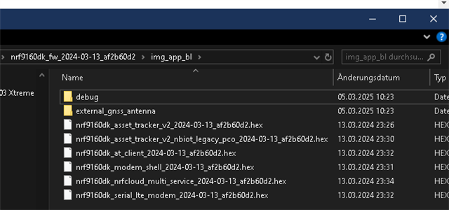

I saw some Segger software tool, and it offers to restore some image from time to time. Could it be connected to this problem?
  • Didrik, greetings.
    Please, tell us: how to use these pre-complied images?
    Are all of them suitable for the Hw v1?
    As is visible from the screenshots above, the device is accessible with the Programmer, when it absolutely does not respond with the Serial Terminal.
    Br., Toni.

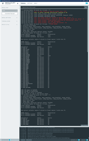

  • Greetings to everybody.
    I have, occassionally, found, that the device (Hw v1) reports something to the Serial Terminal app (v1.4.3):
    *** Booting Zephyr OS build v2.7.0-ncs1 ***
    [00:02:34.510,131] <err> at_cmd: Failed to open AT socket (err:-117)
    [00:02:34.517,211] <wrn> at_notif: Already initialized. Nothing to do
    [00:02:34.524,505] <inf> asset_tracker: Asset tracker started
    [00:02:34.530,670] <inf> watchdog: Watchdog timeout installed. Timeout: 60000
    [00:02:34.538,269] <inf> watchdog: Watchdog started
    [00:02:34.544,281] <err> nrf_cloud_client_id: Failed to obtain IMEI, error: -1
    [00:02:34.552,154] <err> nrf_cloud_transport: Could not obtain configured client ID, error: -1
    [00:02:34.561,523] <err> asset_tracker: Cloud backend could not be initialized, error: -1
    [00:02:34.570,465] <err> asset_tracker: LTE link disconnect
    [00:02:34.576,751] <err> asset_tracker: lte_lc_power_off failed: -14
    *** Booting Zephyr OS build v2.7.0-ncs1 ***down modem

    I: Secondary image: magic=unset, swap_type=0x1, copy_done=0x3, image_ok=0x3
    I: Boot source: none
    I: Swap type: none
    I: Bootloader chainload address offset: 0x10000

    [00:02:34.510,009] <err> at_cmd: Failed to open AT socket (err:-117)
    [00:02:34.517,089] <wrn> at_notif: Already initialized. Nothing to do
    [00:02:34.524,414] <inf> asset_tracker: Asset tracker started
    [00:02:34.530,578] <inf> watchdog: Watchdog timeout installed. Timeout: 60000
    [00:02:34.538,177] <inf> watchdog: Watchdog started
    [00:02:34.544,189] <err> nrf_cloud_client_id: Failed to obtain IMEI, error: -1
    [00:02:34.552,093] <err> nrf_cloud_transport: Could not obtain configured client ID, error: -1
    [00:02:34.561,462] <err> asset_tracker: Cloud backend could not be initialized, error: -1
    [00:02:34.570,404] <err> asset_tracker: LTE link disconnect
    [00:02:34.576,721] <err> asset_tracker: lte_lc_power_off failed: -14

    The MFW you tried has a sdk-2.8.0 suffix, indicating that it was built for nRF Connect SDK (NCS) v2.8.0. Meanwhile, your Asset Tracker app has a 2021 prefix, indicating that it was built in 2021, which is before NCS v2.8.0 is released.
    What I mean is, those two files are likely not released and tested together.
    I recommend using firmware from the same package release, such as 2024-03-13_af2b60d2.
    After you recover your device to working condition, I recommend following our Quick Start guides to continue. See:
