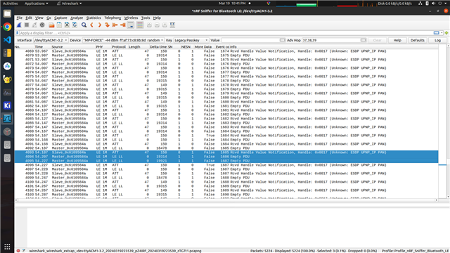

  • Hello I have it partially working, I tried to solve the problem in this few days before asking here again but I still can't, so here I am.
    I have set the connection interval to 10ms so that if a notification is queued it will not fill the buffer.
    Sniffer shows notifications are sent with inteval of 20ms but occassionally there is a 10ms gap notification which is expected.
    As I have said before the event done of SAADC triggers at 19.715ms so my ble gatt notify is triggered after this. And It is lacking 285 micro seconds to complete the 20ms interval before sending the ble gatt notify. Thats why I added the delay for experiment before.
    So thats what I suspect why notifications are queued too much if interval is set only to 20ms.
    I tried also using the timer in this example but upon running this modified example and checking the logs the interval of 19.715ms is also shown from setting of timer of 20ms.
    I am not sure that I still understand the need for the timer here, since the notification can be queued at 19 ms and sent a 20 ms without issue - it does not need to be queued directly before the upcoming connection event.
    Could you share the sniffer trace, so that I may take a look?
    xproto said:
    Out of curiosity can the retry be disabled if not sent.
    No, this is part of the BLE specification and so it can not be disabled.
    You could potentially use an Isochronous channel instead, where packets can time out if they are not sent quickly enough, but this would open the door to loose data in the link, as previously discussed.
    The easiest would just be to have a sufficiently sized ring-buffer to hold any notifications that fail to queue for the duration of the Connection supervision timeout, to avoid loosing any data in the link.
    It set it to 20ms interval. Its working now. I am not sure why it overflows before. Their is an occasional data missed but I think this is tolerable.
    Please share the full sniffer trace, i.e upload the pcapng file directly using the Insert -> File option.
    Seeing only a screenshot gives only a very small glimpse of the communication at the time.
    Did you achieve the desired throughput in this scenario/test?
