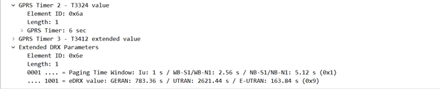

I'm trying to use the GNSS-sample with LTE in PSM. I tried to set the active timer to 6 seconds instead of the default 16 seconds. However after inspecting in Wireshark I see that it's never granted. Here is the Attach Request:

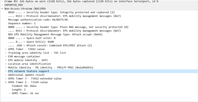

Here is the Attach Accept:
As you can see it says nothing about PSM and eDRX and just sets the active time to 16 seconds. My question is what is going wrong and can I do anything about this?
