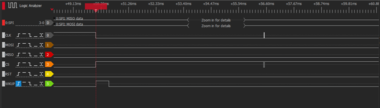

Implementing a low level driver for the Dw1000 with Zephyr OS[SPI interface]
I'm trying to communicate with the DW1000, a radio transceiver and receiver that uses UWB technology. Unfortunately I couldn't find any examples on the Nordic or Zephyr sites.
After searching the internet, I found a library and examples within the Zephyr OS ecosystem that would allow communication with the DW1000 chip. The only problem is that the SPI implementation is missing. I also discovered a fully implemented SPI driver within the nRF SDK 15 that uses the same library. Using this, I created two projects: one with Zephyr OS, where I implemented the SPI driver, and another with the nRF SDK 15.
I'm working with a development kit that integrates both the nRF528232 and the DW1000 into a single chip. This integration is a pain because I can't use my logic analyzer to monitor the SPI pins for debugging purposes. So, I run a simple example where I am only reading out the chip ID from the DW1000. The project with nRF SDK 15 worked, meaning I got the correct ID back from the DW1000 (ID: 0xdeca0130). The project with Zephyr OS did not work, I got 0xFFFFFFFF. Most likely the bug is in SPI implementation. The simple example is waking up the DW1000 with a high pulse on the wake up pin, and resetting the DW1000 by pulling the reset pin to the ground for some time and then releasing it. Afterwards the ID is being read.
Below are both main, and the SPI implementation of the projects:

        r = dwt_readdevid();
        if (DWT_DEVICE_ID == r)
                printf("Correct UWB.");;
        if (DWT_DEVICE_ID != r)
                printf("Incorrect UWB.");;
                while(1){};
        return 0;

int openspi()
    spi_cfg = &spi_cfgs[0];
	spi = DEVICE_DT_GET(SPI1_NODE);
	if (!spi) {
		printk("Could not find SPI driver\n");
		return -1;
	spi_cfg->operation =  SPI_TRANSFER_MSB | SPI_WORD_SET(8) | SPI_OP_MODE_MASTER /*| SPI_HOLD_ON_CS*/;
	spi_cfg->frequency = 2000000;
	nrf_gpio_cfg_output(DW1000_CS_PIN);
	nrf_gpio_pin_set(DW1000_CS_PIN);
	memset(&tx_buf[0], 0, BUFFER_LENGTH);
	memset(&rx_buf[0], 0, BUFFER_LENGTH);
	bufs[0].buf = &tx_buf[0];
	bufs[1].buf = &rx_buf[0];
	tx.buffers = &bufs[0];
	rx.buffers = &bufs[1];
	tx.count = 1;
	rx.count = 1;
    return 0;
} // end openspi()

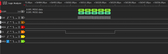

int readfromspi(uint16 headerLength,
                const uint8 *headerBuffer,
                uint32 readlength,
                uint8 *readBuffer)
    //decaIrqStatus_t  stat ;
    //stat = decamutexon() ;
	memset(&tx_buf[0], 0, headerLength+readlength);
	memcpy(&tx_buf[0], headerBuffer, headerLength);
    bufs[0].len = headerLength+readlength;
    bufs[1].len = headerLength+readlength;
	nrf_gpio_pin_clear(DW1000_CS_PIN);
    spi_transceive(spi, spi_cfg, &tx, &rx);
	do{
		spi_write(spi, spi_cfg, &tx);
		spi_read(spi, spi_cfg, &rx);
	}while(false);
	memcpy(readBuffer, rx_buf+headerLength, readlength);
    //decamutexoff(stat);
    return 0;
} // end readfromspi()

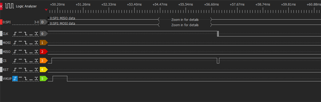

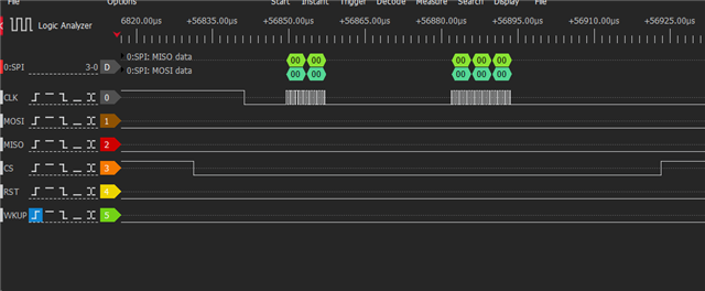

int readfromspi (uint16 headerLength, const uint8 *headerBuffer, uint32 readlength, uint8 *readBuffer)
    uint32 length = headerLength + readlength;
    uint8 m_spi_rx_buffer[length];
    uint8 m_spi_tx_buffer[length];
    memset(m_spi_rx_buffer, 0, length);
    memset(m_spi_tx_buffer, 0, length);
    memcpy(m_spi_tx_buffer, headerBuffer, headerLength);
    nrf_drv_spi_transfer(&m_spi_instance, m_spi_tx_buffer, length, m_spi_rx_buffer, length);
    memcpy(readBuffer, m_spi_rx_buffer+headerLength, readlength);
    return 0;
int writetospi(uint16 headerLength, const uint8 *headerBuffer, uint32 bodylength, const uint8 *bodyBuffer)

static uint32_t spi_init(void)
    uint32_t err_code;
    spi_config.frequency = NRF_DRV_SPI_FREQ_2M;
    spi_config.miso_pin = PIN_DW1000_MISO;
    spi_config.mosi_pin = PIN_DW1000_MOSI;
    spi_config.sck_pin  = PIN_DW1000_CLK;
    spi_config.ss_pin   = PIN_DW1000_CS;
    err_code = nrf_drv_spi_init(&m_spi_instance, &spi_config, NULL, NULL);
    return NRF_SUCCESS;
static void log_init(void)
/**@brief Function for application main entry.
    log_init();
    uint32 r  = 0;
    // Configure Wake up pin
    nrf_gpio_pin_clear(PIN_DW1000_WAKEUP);
    nrf_gpio_cfg_output(PIN_DW1000_WAKEUP);
    // Configure SPI
    spi_init();
    // Wake up
    nrf_gpio_pin_set(PIN_DW1000_WAKEUP);
    nrf_delay_us(500);   //500 us to wake up
    nrf_delay_ms(2);
    // Reset dw1000
    nrf_gpio_pin_clear(PIN_DW1000_RST);
    nrf_gpio_cfg_output(PIN_DW1000_RST);
    nrf_delay_ms(2);
    nrf_gpio_cfg_input(PIN_DW1000_RST, NRF_GPIO_PIN_NOPULL);
    nrf_delay_ms(2);
        NRF_LOG_INFO("Correct UWB.");;
        while(1){};
    while(1){};

In order to see what is happening on the SPI pins, I used the board nrf52-DK and looked what the logic analyzer is giving me:
1. nRF Connect SDK project:
2. nRF SDK 15 project:
You can see the difference in the clock pin. In the nRF SDK 15 project the CLK is low when the SPI is configured. With the nRF Connect SDK the CLK pin is high until the data is sent. A small difference is that the nRF SDK sends all 5 bytes at once, with the nRF Connect SDK you can see that it sends 2 bytes first and then the rest. Below is a picture where I have zoomed in:
Could this difference be the reason why my SPI implementation does not work with the nRF Connect SDK? I've looked in the spi_config settings, searching for any flags that might keep the CS pin high until the transmission, but haven't found anything that could help me. Both of my projects are configured to use SPI mode 0 (with CPOL and CPHA set to zero).
