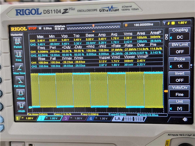

  • By signals do you mean the PWM for the external clocks? If yes, I have tested it on an oscilloscope and the signals had the expected output. If by signals you mean the I2S output itself, I haven't tried that on an oscilloscope yet. Anyway for the follow up question regarding the SCK and LRCLK, do I still need to assign pins for them if I want to use the I2S as a slave?
    Another follow-up. Since the microphone wants 32bit SWIDTH (which is why I am using slave mode), what do I enter in this line '#define SAMPLE_BIT_WIDTH    xx'? I tried running it with 32 but it won't start streams with that.

    By signals I assume he meant SCK, LRCLK, SDOUT and SDIN.
    You most certainly do. In slave mode these pins will be inputs rather than outputs, but without them no data will be sent or received, which could explain why you see the EAGAIN (-11) error when trying to read I2S data.
    In master mode the nRF will output data whether or not anything is connected, but in slave mode this is not the case.
    If you want the nRF device to be the slave it means the SPH0645 has to be the master. Are you sure that this is supported in this device?
    I would start by checking that the SPH is actually outputting data on the SCK, LRCLK and SDOUT pins. Once you have confirmed this you can try to connect these pins to the nRF device, and verify whether or not you can see the data received on the nRF side.
    Best regards
    Torbjørn

  • Hi Daniel
    Sorry for the slow response, many of us where out in Easter holiday last week.
    Thanks for providing links to the blog you followed, now I understand better what you are trying to do.
    I agree that this method should be viable, but this is not something we have tested internally.
    Do you make all the external connections as described in the readme of the github repo, to wire the two PWM signals to the I2S SCK and LRCLK pins?
    It seems you don't configure the SCK and LRCLK I2S pins in your overlay. Are you sure that these pins are set correctly?
    Again a scope trace would be useful, to verify that the signals going into the nRF I2S lines is correct.
    Best regards
    Torbjørn
  • Hello, I adjusted my pinctrl in the overlay to configure the SCK and LRCLK for slave mode. I also connected wire lines to follow this

    I'll try to use an oscilloscope ASAP to check for signals. BTW if it matters, the most common errors I get is on the i2s_read() part where it outputs -5 and sometimes -11.
    Last question, how can I extract the audio data from the i2s memory to send it to another device using BLE? Thank you for your response!
  • Btw, if you are asking me to probe the PWM signals using oscilloscope I already have results on that. It showed correct frequency and good 50 duty cycle. The Frequency of CH1 signal is 4MHz if zoomed in. It just shows 5MHz because of zoom out.
