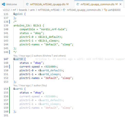

Add UART1 in Devicetree address range collides with others peripherals
Hi Supporter
                     I use nRF7002-DK, toolchains and SDK version use v2.5.2, I try to modify Devicetree for  nrf5340_app_common.dts file for add UART1 node, when I view visual editor as below, found UART1 and i2c register address was collidesed as below red color highlight, how can I escape or improve like that issue, Thanks.
my nrf5340_cpuapp_common.dts as below

arduino_i2c: &i2c1 {
    status = "okay";
    pinctrl-0 = <&i2c1_default>;
    pinctrl-1 = <&i2c1_sleep>;
&uart0 {
    status = "okay";
    current-speed = <921600>;
    pinctrl-0 = <&uart0_default>;
    pinctrl-1 = <&uart0_sleep>;
&uart1 {
    status = "okay";
    pinctrl-0 = <&uart1_default>;
    pinctrl-1 = <&uart1_sleep>;

arduino_serial: &uart1 {
