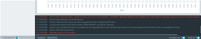

If i use jlink this is the error i'm getting this below given error.

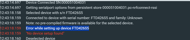

if i use the usb/UART, i get this error

    I would expect the jlink instance to work so that makes sense to me. As for the DTM I need to investigate

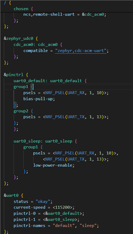

  • I couldnt run the radio test too, this is my usb.overlay set based on the custom board. Do i have to set any connection between jlink and the UART on Realterm/Serial connection/putty? for it to work.  As of the hw connection is

    This is the output i see for the radio test, atleast the DTM was making connection with the FTD, but this one not doing that too.

    I'm sorry but I keep mixes up a few cases. In this case you have a custom board with only one UART right and this goes through a Jlink? The uart pins looks fine from what I can see, and they are connect how to your computer?
    Also did you include this in your overlay? I could not see it from the image
    	chosen {
    		ncs,dtm-uart = &uart0;
