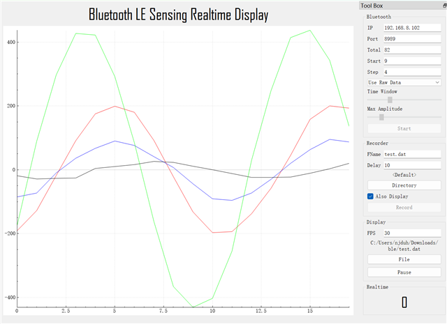

    I am also interested in bluetooth aoa. From my experiment,if I set ant_patterns to 0x1 0x1 0x2 0x3 0x4, the antenna switching pattern will be 0x1 0x1 0x1 0x1 0x1 0x1 0x1 0x1 (8 times) 0x2 0x3 0x4 0x1 0x2 0x3 0x4 0x1 0x2 0x3 0x4(include 0x01). When I set this ant_patterns, and according to my point of view,plotting the IQ of the same antenna will give a sine wave (although it should be a straight line in theory, the clock deviation causes it to look like a sine wave).

    I tried to set the ant_patterns={ 0x1 0x1 0x2 0x3 0x4}, but the phase_diff seems no rules...

    3、Previously, I set all twelve antennas in ant_patterns to 0x1, then measured the phase difference from the same antenna to estimate this △phase, but the results seem irregular, possibly due to frequency hopping effects.
