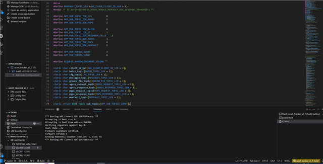

     im using nRF9160dk ,sdk version 2.5.1 .When I open the sample code of  asset tracking v2 application code I can successfully build the code but when I tried to flash the code I'm getting this fatal error ,but I can flash remaining code like nRF cloud multiservice code and all sample codes successfully and got output also but why I can't flash asset tracking code.below I shared the error.
Building asset_tracker_v2_1
C:\Windows\system32\cmd.exe /d /s /c "west build --build-dir c:/Users/mdharumalingam/aws_iot_1/asset_tracker_v2_1/build c:/Users/mdharumalingam/aws_iot_1/asset_tracker_v2_1"
[0/47] Performing build step for 'mcuboot_subimage'
ninja: no work to do.
[1/38] Performing build step for 'b0_subimage'
[2/35] Performing build step for 's1_image_subimage'
[3/27] Performing build step for 'tfm'
* Terminal will be reused by tasks, press any key to close it.
* Executing task: nRF Connect: Flash: asset_tracker_v2_1/build (active)
Flashing build to 960098217
C:\Windows\system32\cmd.exe /d /s /c "west flash -d c:\Users\mdharumalingam\aws_iot_1\asset_tracker_v2_1\build --skip-rebuild --dev-id 960098217"
-- west flash: using runner nrfjprog
-- runners.nrfjprog: Flashing file: c:\Users\mdharumalingam\aws_iot_1\asset_tracker_v2_1\build\zephyr\merged.hex
[ #################### ] 12.269s | Erase file - Done erasing
[ #################### ] 2.944s | Program file - Done programming
[error] [ nRF91] - Failed while performing 'Verify' operation on target address 0x00FF8130.
-160: Data does not match in address range [0x00FF8130 - 0x00FF817F] (UICR)
Expected byte value 0xDC but read 0xC0 at address 0x00FF8140.
[error] [ nRF91] - Failed while verifying device. -160: Data does not match in address range [0x00FF8130 - 0x00FF817F] (UICR)
[error] [ Worker] - Data does not match in address range [0x00FF8130 - 0x00FF817F] (UICR)
[error] [ Client] - Encountered error -160: Command verify_file executed for 2983 milliseconds with result -160
ERROR: Write verify failed.
NOTE: For additional output, try running again with logging enabled (--log).
NOTE: Any generated log error messages will be displayed.
FATAL ERROR: command exited with status 25: nrfjprog --program 'c:\Users\mdharumalingam\aws_iot_1\asset_tracker_v2_1\build\zephyr\merged.hex' --sectorerase --verify -f NRF91 --snr 960098217
* The terminal process terminated with exit code: 25.

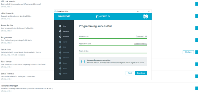

  • Hi Purushothaman,
    I am also using nRF9160DK v1.1.0 now.
    Could you give a last try by programming thingy91_asset_tracker_v2_2024-03-13_af2b60d2.hex  with nRF Connect for Desktop->Programmer APP.
    If it still gives the same result, I also run out of idea why this happens.Please send me pictures of your nRF9160DK from both sides, just in case it is some HW issues.
    Charlie

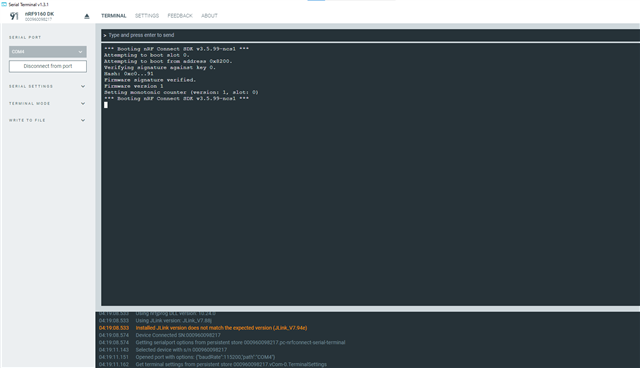

        Thank you for your help. After following your instructions asset tracking code is producing log outputs without any issue.
    *** Booting nRF Connect SDK d96769faceca ***
    Attempting to boot slot 0.
    Attempting to boot from address 0x8200.
    Verifying signature against key 0.
    Hash: 0xb0...7c
    Firmware signature verified.
    Firmware version 1
    Setting monotonic counter (version: 1, slot: 0)
