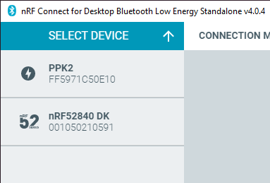

I just bought a nrf52840 to be able to work with nrfConnectDesktop BLE sniffer tool
I've plug the nRF52840 board using IMCU USB
when I try to select the device it finds the 52840 board

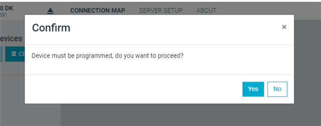

once selected it ask for a firmware update

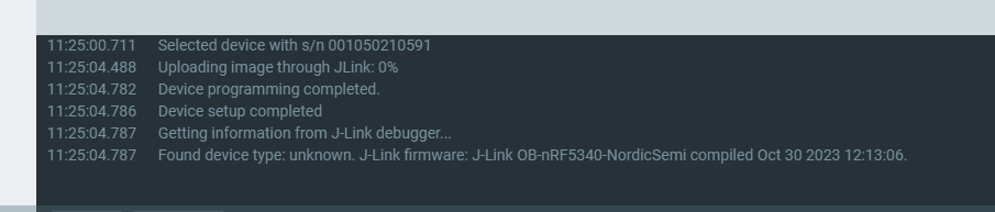

firmware download looks a bit too quick and log goes like this
after firmware flash I have no data and if i try to reconnect it asks again for firmware flash
I think I have an issue with FW flash obviously but did'nt know what to try ...

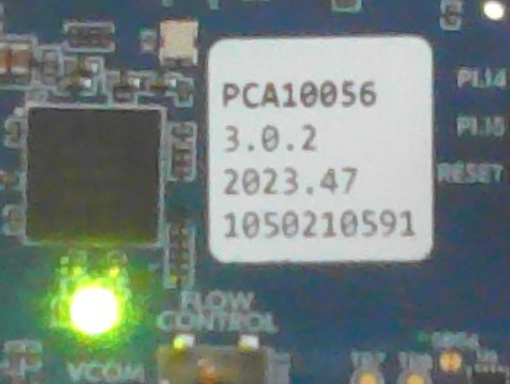

  • I'm using a nRF52840-DK
    sticker on board says :

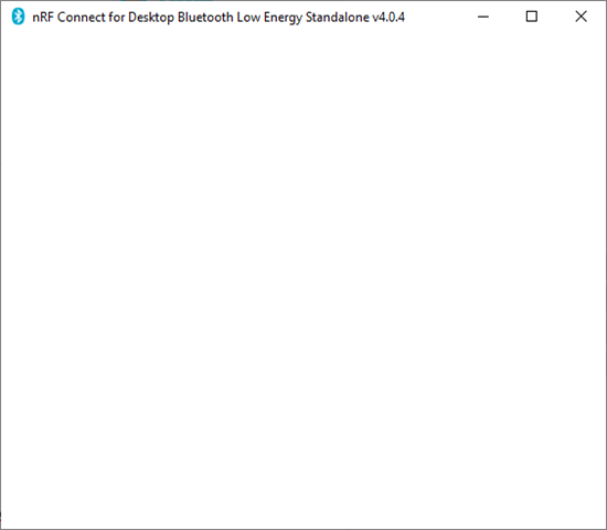

    when I try to open ble tool from nrf connect desktop it opens bluetooth low enegy v 4.0.4 patch1 and its closes immediatly to open standalone v4.0.4
    in order to avoid error when opening
    I have c;lose all nrf app and tryc to start directly standalone ble tool I have same issue
    I have also try to uninstall standalone revision to stick to desktop suite only and it continue to close immediatly first window and opens standalone rev but window stays empty now
    nrf connect is rev 4.4.1
    in order to avoid any miss instalation I've wipe out nrfConnectDesktop and ble standalone tool
    reboot and reinstall freshly downloaded 4.4.1 nRfConnectDesktop but it same result first window close immediatly and standalone ble tool is oppen even if it's not installed =| !!
  • What OS are you using here? Can you install nRF Command Line tools just to check that for instance "nrfjprog --recover" works?
    Can you try to push "Ctrl + R" when you experience white screen to check if it reloads?

  • ok after a recover a standalone Bt tool reinstall it looks to works correctly thanks a lot for your help !
