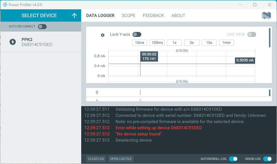

I am having troubles to connect the Power Profiler Kit II to my computer running the Power Profiler v4.0.0 app from nRF Connect for Desktop on Windows.
More precisely I get the following error: "No device setup found".

Hi Jared,
Can you try with another computer, the result would tell us if the issue is related to your PPK2 or the nRF Connect Desktop installation,

I reinstalled the nRF Connect for Desktop app on my computer.
Then I launched the Power Profiler app that managed to detect and automatically update the firmware of the PPK2 device. After that, the device was successfully connected and I am able to measure current consumption.
I suppose the PPK2 device firmware was corrupted.
