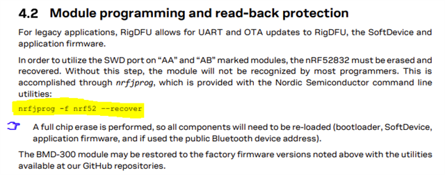

Hi, I got a brand new u-blox BMD-300-A-R soldered onto my custom PCB. I have connected the SWDIO, SWDCLK, VDD and GND to my nrf52dk according to instructions here (nRF52 Series > nRF52832 > nRF52 DK > Hardware description > Debug out for programming external boards).
I opened the Programmer v4.3.0 in nrf connect for desktop. It detected the J-Link device, but it says "No operations possible for device. If the device is a MCUboot device make sure it is in the bootloader mode". I think it's because it's a brand new MCU and doesn't have bootloader in it.
I only have a nrf52dk in hand. Can I use it to burn bootloader onto my MCU? If so, how can I do it? Thank you very much!

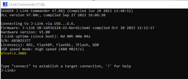

    Also, when I try to connect to my custom board in Programmer v4.3.0, the JLink device no longer appears. Instead, it's nRF52 DK, with UNKNOWN_FAMILY. The console says
    Failed to reading readback protection status for application core core. Error: [object Object], message: Batch task protection-get failed, [jlink] JLINKARM_DLL_ERROR
    Error: Failed with exit code 1. One or more batch tasks failed: - [jlink] JLINKARM_DLL_ERROR, code: Nrfjlink. Message: Batch task protection-get failed, [jlink] JLINKARM_DLL_ERROR.

    Can you execute  "nrfjprog -f nrf52 ––recover"? If not, please provide the log.

  • Do you also provide power to the custom PCB? Make sure the J-Link commander can detect it as 3.3v.
