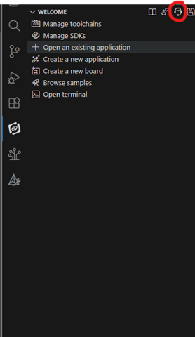

  • Hi Geoff
    Please generate support information by pressing this button in the nRF Connect extension of VS Code, and we can take a look at the logs there.
    It also seems to be discussed in this Github issue thread for reference. I'll try to keep an eye out for updates there as well, but we also have an internal discussion on this. https://github.com/zephyrproject-rtos/zephyr/issues/72963
    Simon
