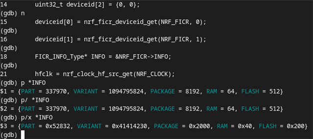

Found the reason:
I used the debug output from a nRF52832 DK, for some reason, it debugged onboard nrf52832 instead external nRF52840.
I read the FICR INFO registers to find it out.
Then a question is: doesn't JLink verify Chip ID before entering debug status ?

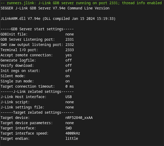

What I mean is, although I used west debug with nRF52840 as target, JLink still can connect to nRF52832 on the board.
I thought it may check and failed to connect to 52832
You have to set the target correctly. See the reply from the Segger team:
