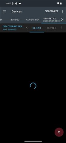

I have been using the nrf connect mobile app (on android) to assist in debugging and testing of BLE applications before. Now I am working on a peripheral that has some custom services and also can operate as a broadcast sink. I was successfully able to connect and discover services and write and read from the characteristics when the peripheral was just advertising as a peripheral and then scanning for and syncing to a broadcast stream. But when I add the necessary configs for BAP (CONFIG_BT_BAP_BROADCAST_SINK and it's dependencies) the mobile app is stuck in discovering the services and characteristics.
I am still able to discover and write to the peripheral with a modified version of the nrf5340 audio gateway application, so I am wondering what might be missing to make it work with the mobile app? Should it be possible, or is there some missing support here?  I have tested with a phone with Android 14 which supposedly has support for LE Audio. (Google Pixel 7 pro)
To be clear I am not expecting to actually test and debug LE Audio with the mobile app, I just want to be able to interact with my custom services.

    nrf Connect mobile app when auto discover is on:
    Auto discover off, not able to read characteristics:
    I also have tested with this sample https://github.com/rick1082/sdk-nrf/tree/nus_on_bis_headset/applications/nrf5340_audio which sets up a NUS server on the headset (just modified to use v2.6.0 instead of 2.3.0) and it has the same behaviour. Log:

  • Thanks for the information. We are checking with the app team. I will be back when I collect enough information.
    The new version v4.28.1 should fix this issue. Our APP expert pushed the latest version to the Play Store which will be available soon.
    -Amanda H.
  • Cool, thank you! I will test as soon as I receive the update :)
    v4.28.1 is on the Google Play Store now.
    -Amanda H.
