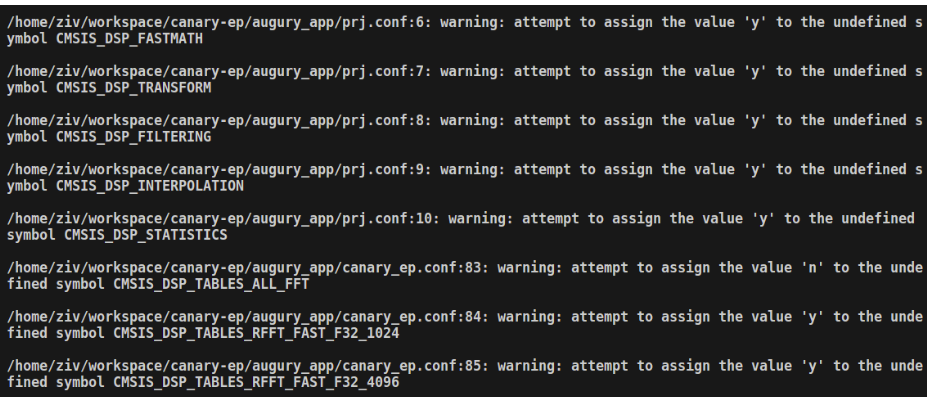

2. we use cmsis dsp
and now they are all undefined so what can i use instead , cause i have undefined api in mt code now ?

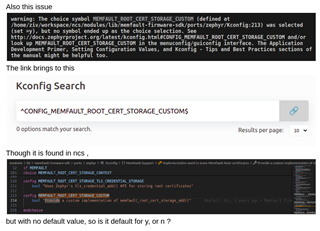

4. init a device with APPLICATION level is deprecated now, what can i do instead ?

    2. we use cmsis dsp
    There is an overview over the available configurations here. Simply search for CMSIS_DSP to see what is available on a given version of NCS. Could you try to simply remove the configs that aren't supported and see what error you get? Maybe CONFIG_CMSIS_DSP will cover a lot.
    3.
    Here it is: CONFIG_MEMFAULT_ROOT_CERT_STORAGE_CUSTOM. I think the link brought you to the latest version of Zephyr, in which it might not be anymore. I guess it defaults to not being selected. Could you expand a bit on the issue here?
    I'll have to get back to you on this part, but I guess we might as well start with the 3 first points either way.

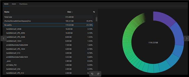

  • i can not get memory report if build fail
    but if i look at the nrf52840 board which i can build and i compare memory report of the same code build in 2.5.0 and 2.6.1 i see 25.52kb diff in Nordic Proprietary Libraries (58.31kb in ncs2.6.1 vs 32.79 in ncs 2.5.0)
    also under the No paths there is a 11kb extra in 2.6.1
    so where does this come from and how can i reduce it back  ?
