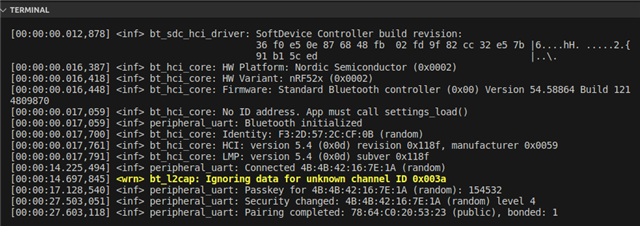

My question is how to implement this in Zephyr on the nRF52840. Some of the code I found for security doesn't seem to actually use Level 4 of security which is what I probably need to use.
Is there example code on securing the nRF52840 with Zephyr at this level?
Our device has a small display but no keyboard. So far I've been trying to put code together from multiple parts but I'm getting errors and all kinds of issues. How do I verify this?
