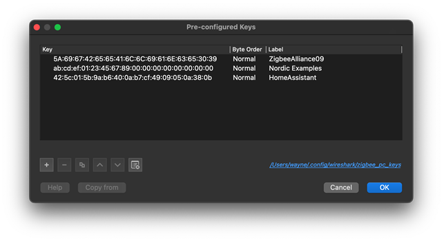

  • Hi Wayne,
    Can you upload your sniffer log here as a pcap file, as well as a screenshot of your pre-configured keys in Wireshark?
    Marte
  • Hi Marte,
    Please find attached a log of issuing a light toggle command a few times. (zcl cmd 0x7be2 1 0x0006 0x02)
    I've also tried setting the network key to that of the HomeAssistant one (the Home Assistant network is off), but it still doesn't decrypt.  EDIT: Just to be clear the key being used for the attached log is the 'Nordic Examples' key.
    Thanks
    Wayne
    toggle_light.pcapng.zip zigbee_pc_keys.zip
