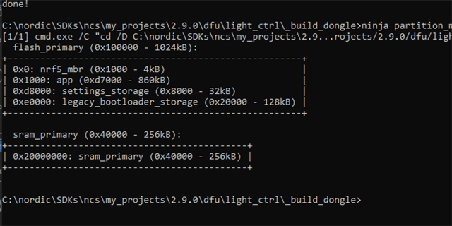

    I see that if I build this for the nRF52840 dongle, it fails because it overflows the Flash. The dongle, unlike the nRF52840 DK doesn't have external flash.
    It doesn't overflow by much, though. You could try to strip out the nRF5 bootloader from the dongle (using an overlay file). So that will give you one more page (4kb) from the beginning, and about 32+128kb more flash at the top of the ram:
    Perhaps it is easier to start with the nRF52840DK board and strip out the external flash. But if you remove the original bootloader from the dongle, then please note that you need to add something to your own bootloader setting the correct regulator settings. Please read about this in this blog post:
     nRF52840 Dongle Programming Tutorial
    Particularly the section: "Adapting firmware to set REGOUT0 properly"
    Edvin
