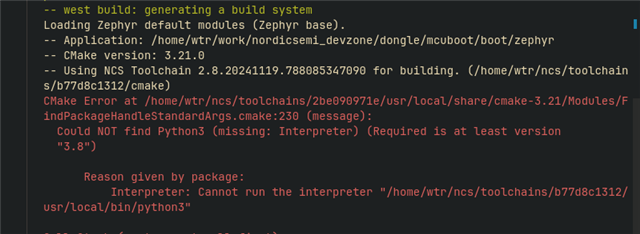

    west build -b nrf52840dongle_nrf52840 -d build/mcuboot mcuboot/boot/zephyr
    Suffer because the toolchains aren't actually working as one would be misled to think with step 1. Notice 2be090971e and b77d8c1312.
    Step 4 Spend the better part of your life searching for a fix ...eventually find the -DNCS_TOOLCHAIN_VERSION flag allows it work when set to NONE or 2.6.1...it seems my environment in terminal was not the only thing needed.
    This reminds me of a bug we had at some point. For debugging purposes, is it possible to delete all NCS versions after the one that you are using? I don't recall exactly what version it was, but it may have been around there, where it took the latest toolchain version, even though specifying another one.

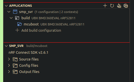

  • I can start working from only one toolchain.
    The question is which I can't find a dfu tutorial in the intermediate course for 2.9.0, only 2.6.1.

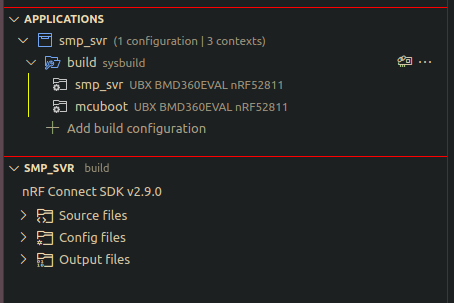

    However running smp_svr sample on v2.6.1 I get
    Running v2.9.0 I get

  • Is it impossible to build with v2.9.0?
    This is a capture of steps taken to try and implement the smp_svr demo.
    1. Open terminal, make project work directory
    ❯ cd ~/work
    ❯ mkdir nrf_connect
    ❯ cd nrf_connect
    ❯ code .
    2. Within vscode nrf_connect extension tab.
    * Create a new application.
    * Copy a sample
    * Select nRF Connect SDK v2.9.0
    * Select zephyr/samples/subsys/mgmt/mcumgr/smp_svr
    * Name it ~/work/nrf_connect/discord_demo/
    3. Setup vscode workspace so that it's in ~/work/nrf_connect/discord_demo/
    4. Within the nrf_connect applications add a build configuration.
    * Set toolchain and sdk (2.9.0)
    * Set board target nrf52840dongle/nrf52840
    * For Extra Kconfig fragments add overlay-cdc.conf (imported with when project was created with sample)
    * For Base Devicetree overlay add usb.overlay (imported with when project was created with sample)
    * For cmake add  DMCUBOOT_OVERLAY_CONFIG="mcuboot.conf"
    Fail because of flash...when i inspect the west build command i see
    west build --build-dir /home/wtr/work/nrf_connect/discord_demo/build /home/wtr/work/nrf_connect/discord_demo --pristine --board nrf52840dongle/nrf52840 -- -DNCS_TOOLCHAIN_VERSION=NONE -DEXTRA_CONF_FILE=overlay-cdc.conf -DDTC_OVERLAY_FILE=usb.overlay -DBOARD_ROOT=/home/wtr/work/nrf_connect/discord_demo
    For some reason this doens't have the mcuboot overlay. which as the config_pm .... size_mcuboot=0x10000
