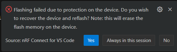

CTRL-AP indicates that the device is secured

Even writing to the flash is successful...
-- west flash: using runner nrfjprog
-- runners.nrfjprog: mass erase requested
-- runners.nrfjprog: reset after flashing requested
-- runners.nrfjprog: Flashing file: c:\GitHub_Repository\peripheral_2\build\zephyr\zephyr.hex
[ #################### ]   0.294s | Erase file - Done erasing
[ #################### ]   1.460s | Program file - Done programming
[ #################### ]   1.481s | Verify file - Done verifying
Applying pin reset.
-- runners.nrfjprog: Board with serial number 960157638 flashed successfully.
even if the following message sometimes appears:
Unfortunately, however, the application does not work. I should see a BLE device with the name "Zephyr Peripheral Sample Long Name" but nothing.
